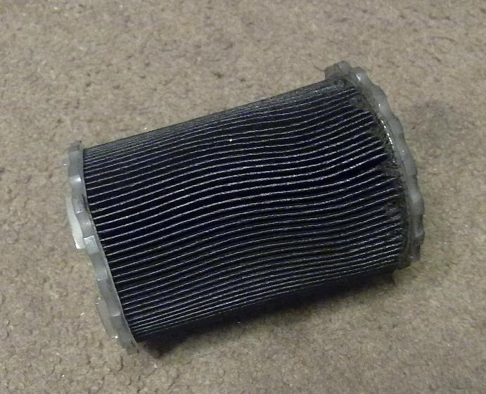

I just changed my fuel filter on my '05 vRS, and I thought I'll post a few pics of the inside.
I must say thanks to Bodge on the info (& Fatty5000 who added it as a tech guide). I have been drowning my Norma clip with WD40 and using a small brush to clean off the muck a few days before hand. So I knew the clip would undo. :thumbup:
And yes the only fuel that came out was mainly from the filter. I did not have 20 litres trying to empty itself on my drive thankfully ;)
I had a litle problem seeing the little button to press on the fuel line clip closest to the tank, I thought it was on the top, where I could hardly get my hand to :( But after wedging my head under the car, I saw it was at the bottom and easy to get to :D
For how difficult they are I do mine every 5K along with oil/filter & air filter wash.
Your filter does look particularly manky!!
