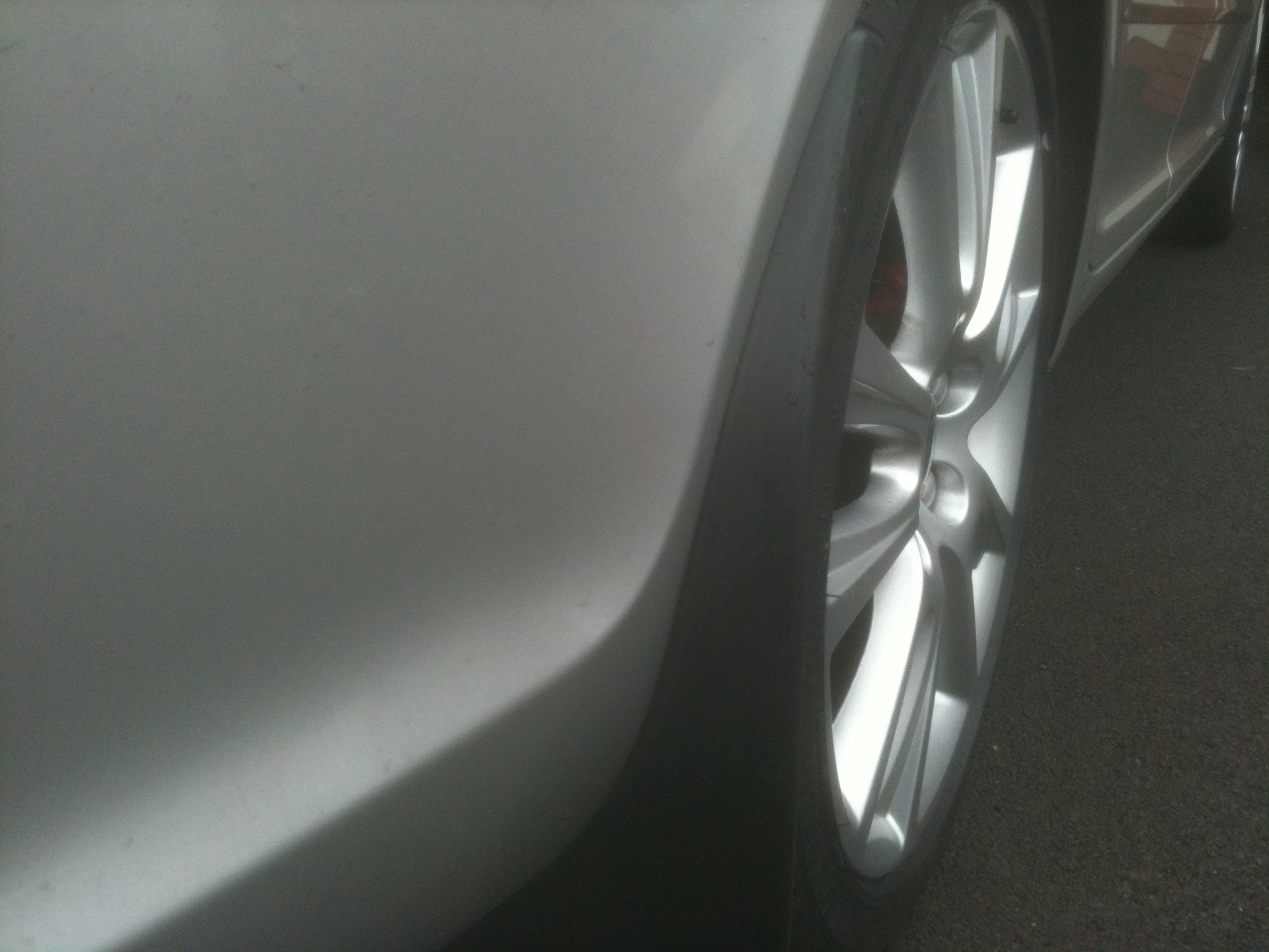

Fitted my rears today. The middle screws (out of the original 3) on both sides didn't line up with the holes so i just self tapped a hole into the flap to line up with the arch hole.
They don't fit perfectly as there are a couple of gaps on the outside where it moulds around the bumper. These hopefully will pass and ease off with time though.
But i can conirm that they do fit!

Fitted rears to mine, but as you say some slight gaps, so used a bit of black silcone sealer from Screwfix to fill gaps.
Not too noticeable - i will see how they bed down before making a mess with silicone!

Nice one cheers for posting back as I said in mine with pics as close to perfect fit as I could get shows the lil gaps youve got too my gaps are still there 3000 miles later but I got that middle screw in by gripping the mud flap just above the hole with a leatherman and pulling it towards inside of wheel arch (back of it) making it sit over hole then put screw in a couple of turns let go and tightened up.
I am happy enough with the lil gap id rather that than not have them at all and its a close inspection thing to really notice it I very much doubt I will fill it with anything !!! JCB360 you've done a great job there but I have used that stuff before im not so neat so will leave it as is on mine great effort though :thumbup:
