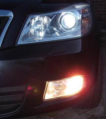

Surely the reason the standard bulbs look orange in the above picture is because they are dimmed to side lights.

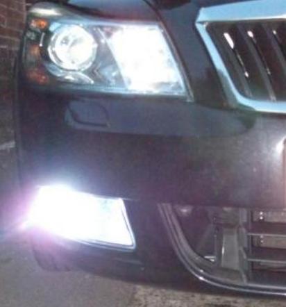

<br />I bought some replacement DRL bulbs for the Octy Elegance from fleabay.  18 SMD LED cluster advertised as Can-bus safe.  Brilliant, the postie dropped them off today so I rushed home to fit them.  I fitted one and after testing it the warning bulb on the dash came on with the message "Check daylight driving light front right".<br /><br />Ahh well - I've contacted the seller
Hi ,
Just realised you've got the drl's on with the headlights ...!!!
How did you do that ? VCDS ?? If yes please do tell me the coding changes ..!
I've got mine with the ADL function ....so it's either drl's or headlights .!

Are you sure that his headlights are on in the pic? it looks like it might just be the light / flash reflecting off the projector?
I haven't seen the option in VCDS to enable them with the headlights .... but then I wouldn't of been looking for it ..... and if someone asked me to activate it I would refuse !! :swear:

Didn't want them personally but was surprised if they could be done at all ....
As I had spent a few hours searching if it was possible to do so .!
A friend had fitted these flea bay drl's and had wired them to the existing drl's ....!! Would be great fr him if it could at all be done ..!
But then could be the flash !!!! LOL<br /><br />Saw the washers so just assumed them to be xenons shinning !!
Only the OP knows for sure but I don't think the headlights are on, as mentioned above my money is on the reflection from the camera flash...
DRL's and dipped headlights should never be on together. DRL's are designed for use in daylight only and are too bright for use at night.
The Elegance specification here in the UK gets the headlight washers as standard even when the optional xenon headlights are not fitted.
Only the LED DRL's on the vRS double up as side lights by dimming.
The incandescent DRL's on the OP's Elegance are either on or off and do not dim.
The side light function uses the usual 5W bulb in the main headlight cluster.
It is the very nature of the LED type DRL's that gives them their bright white appearance and is why they are often retrofitted to replace the yellow look of traditional filament bulbs.
Yep - those are projectors and the flash was bouncing off them..
