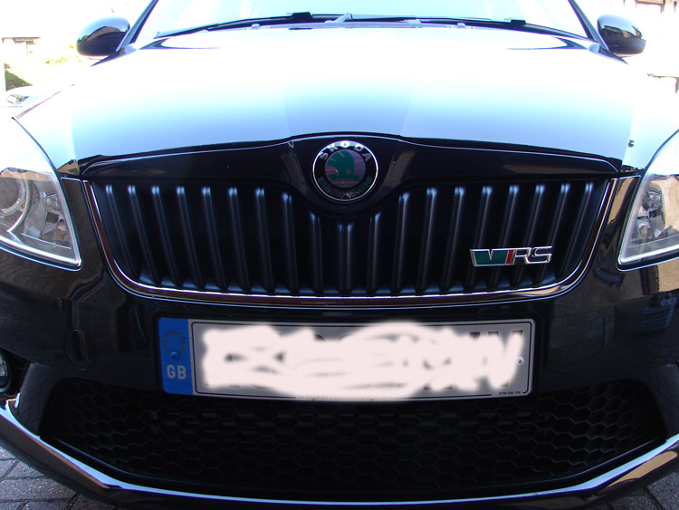

Monte Carlo Grill Mod - Fitted
Is there a part number for the black headlights?

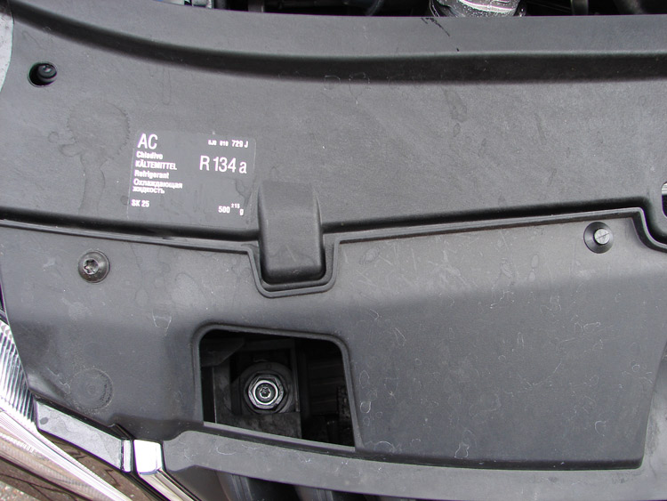

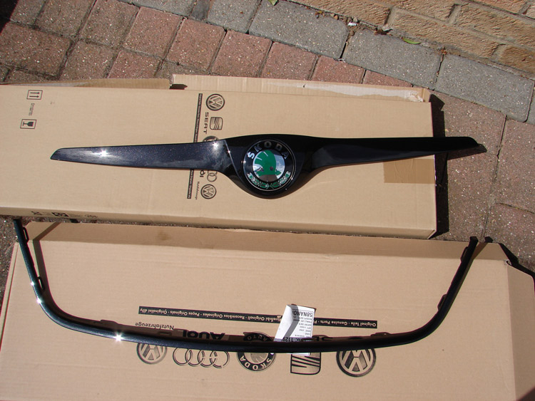

Got the parts today.
Fitting the top part is easy - just remember there is a screw to undo behind the badge !
Fitting the bottom bit is not so easy - the left hand bolt ( second photo) has a nut on the end - its very difficult to get your hand on the nut-
so do you let it just fall off ?
Is the other fastening (on the right of photo) just levered out ?
Must read the OP's instructions again.

PS - Got the top half done - tackle the bottom another day ;)

Top bit with badge about £43 and the lower bit about £20
