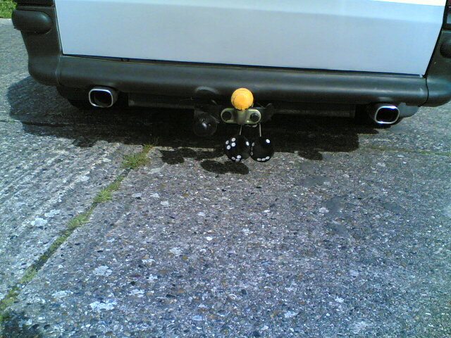

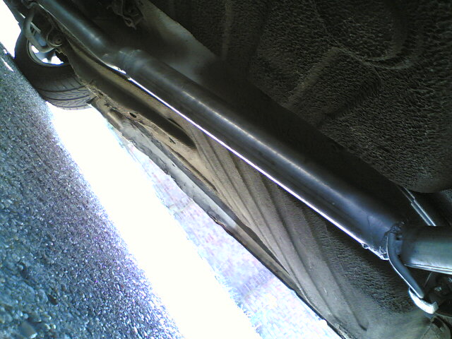

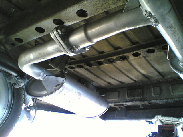

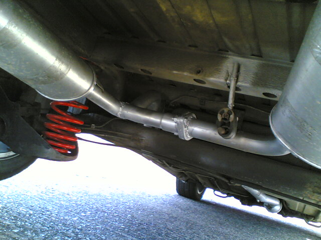

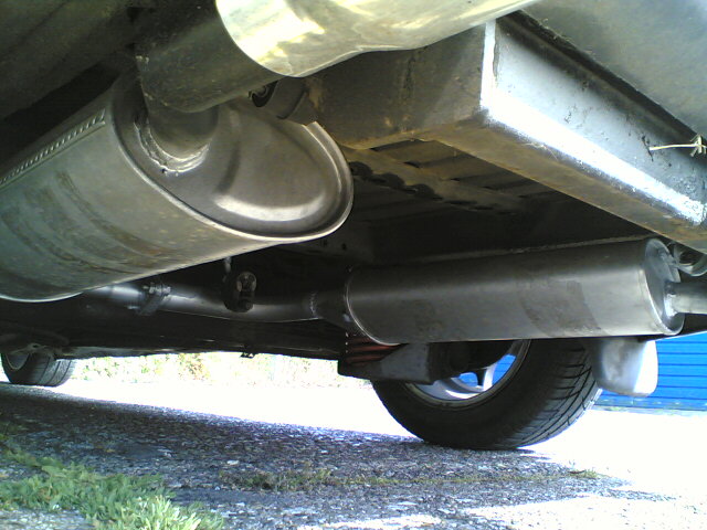

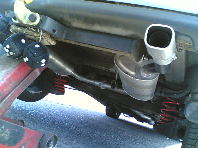

i fitted two standard back boxes, one upside down, joined second box just after axel, welded in flanges so it can be easily removed & replaced centre box with a 53mm pipe, sounds a little louder but not boy racey, cost about £100, all new parts,

hmmm different I guess but nice one for trying something different too, oh and maybe a bit more power and less wire speed next time everyone uses low power thinking it will burn thru exhaust tube :thumbup:
Does much exhaust come out of the offside box (new one)? I'm thinking of farting about with my exhaust over the summer, but I was thinking more along the lines of straight through or a cherry bomb and a de-cat.
looks very nice mate.... good work.
shame it can't be done to the HAtch's, i think the floor pan underbody would require more twists and turns than it worth bothering with
Looks mint :thumbup:
good effort, did you use a gasless mig welder to do that?? like jimbo says a bit more current and you'll be laughing
l
yeah true, the pickup doesn't have a spare wheel well recess into the rear floor panel so there's plenty of room under there to play with... i've even thought about an LPG tank in that space before now
Look good. Nice thinking with just using another back box. I've seen twin exhaust kits for the felly on a CZ site before and they were about £250 I think.
Think you'll need a couple with your planned modification in the engine bay Tom! ;)
