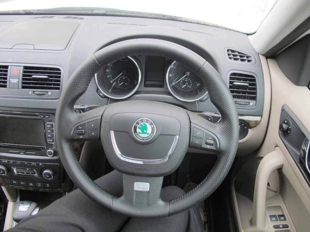

Multifunction three-spoke steering wheel !
Finally arrived :rofl:
My link
Edited by GiscoYeti
What is the badge on the bottom plastic spoke?
Mike
Now thats what a MFSW should look like, not the smooth ones we are fobbed off with as an option on the Yeti.....
By the way, it is missing the flappy paddles......emoticon-0140-rofl.gif (that mine has).
Mike
Looks like a vRS badge to me Mike.
Only for manual gearbox !!! No paddles
I thought it might be.

It took Ben at Shark Performance about 30 minutes to fit and program the MFSW. the programming part took about 30 seconds.....Hardest part was getting the steering wheel on straight emoticon-0136-giggle.gif
Disconnect battery, remove airbag (not so easy if you don't know what you are doing), undo nut remove steering wheel. disconnect wiring. replace with new steering wheel in correct place/orientation & refit nut, reconnect wiring. refit airbag. re connect battery. plug in VCDS & go to relevant section (no idea as not got VCDS) hold the paddles and it was all activated.
Done.
As I said, it took Ben who has done lots of these, about 30 minutes before we were able to drive off.
The paddles work in tiptronic as well as 'D' and 'S'.
