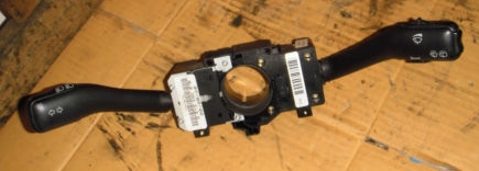

So in an effort to fix this, I've (rashly) bought a Golf Mk4 indicator/wiper stalk pair in the vague hope that they'll fit the octy. Are they the same? (Bit late to ask now I've bought it! :doh: )

Update: problem seems to be fixed by replacing the twin stalks with the Golf item I mentioned earlier in the thread.
