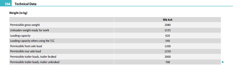

Just been on the skoda.co.uk website and it lists the kerbweight of a Yeti 170 as 1535kg which makes it an 89% match for our caravan. This is good as its better than our current car (which I'll fess up has towed quite securely at 91% for years before anybody starts with the 85% thing). However, the brochure which I downloaded off the same site shows the kerbweight as 1460kg which is not so good, putting us at 94% and that is probably a bit too near the knuckle for me to be happy with. Can anybody please confirm which is correct?

With regards kerb weight, this is what the manual you can download states:

I know what you mean! I have a 170 on order for March ... with my new caravan on tow (due December) I will be somewhere between a 90 and 95% match. I think 1535KG is the one I would take notice of as the 1460KG figure does not include the 75Kg other makers include to take account of the driver and some luggage ... 1460+75 gives 1535Kg! It would be great if it had the 100Kg noseweight limit that the Tiguan has rather than 80Kg.

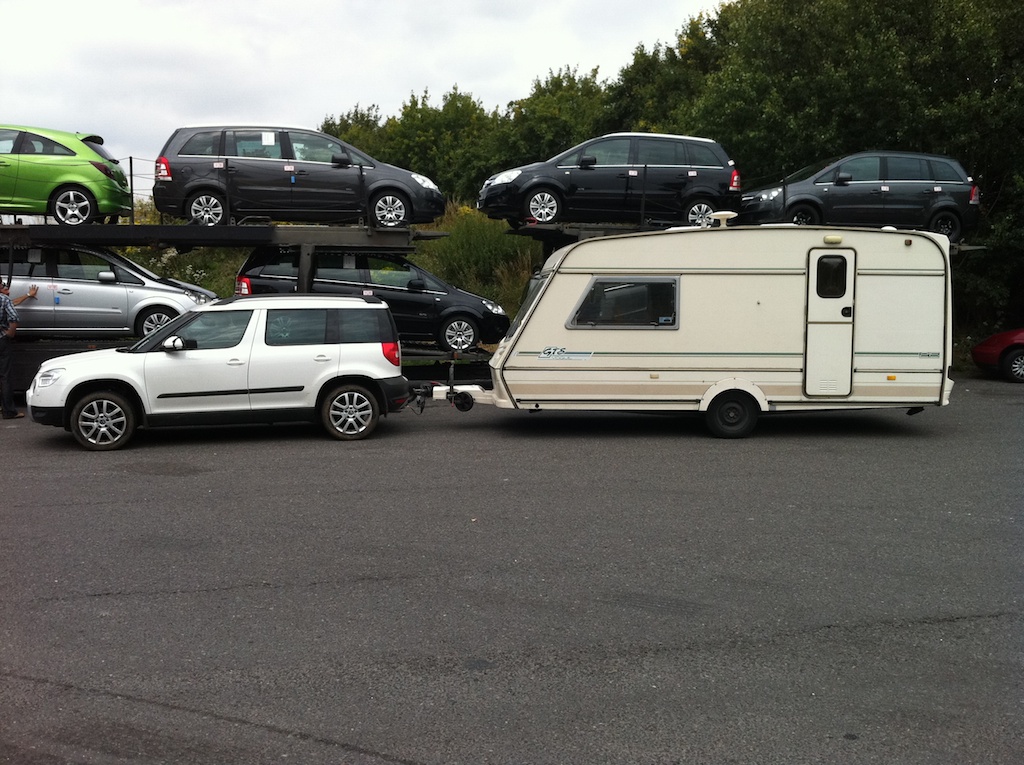

Still not seen a Yeti towing or on site ... but sure it will be great.
And another one.....
