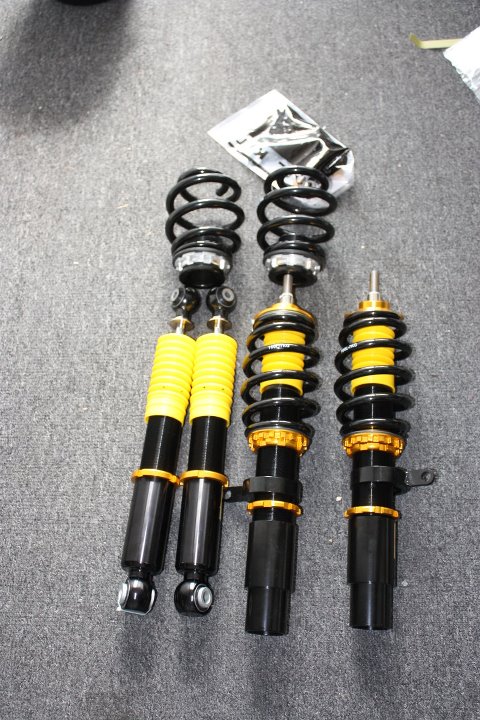

The ones the local company have are these:
http://www.yellow-speed.com/dynamic-pro-sport.php
Pictured are the ones the guy has on his S3 which used to have VMAXX fitted. He reckons the ride is much better.
They're damping and rebound adjustable.
They're half the price of the Kw V3s and probably for good reason but 3 grand is a lot of money.
I tried to get him to give me a money back guarantee :D
From some Googling I found people using them on MX5s and Lexuses and the odd Beemer and they all had good things to say.
