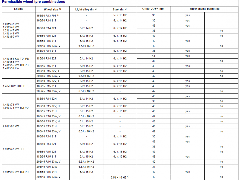

  • Just adding this table screenshotted off workshopmanuals.com as it includes all the info for MK1 Fabia, including load and speed ratings, and offsets. The Mk1 forum seems to be full of queries ab

OEM = 205/45 R16 has a R/C of 1856.37mm....-2.5%= 1809.96mm....+2.5%= 1902.78mm
Width = 225/35 R17 R/C = 1851.34mm
Winters = 195/55 R15 R/C = 1870.82mm (watch the brake/wheel clearance!)
Skoda say winters should be 185/55R15, printed on the inside of the filler cap and in the pdf guide listing all permitted wheel & tyre sizes. This size allows snow chains to be used.
If, as seems likely, there is no adjustment for speedo reading between models, the most common size of 185/60R14 should probably be considered the nominally correct size for car. On this basis, 205/45R16 is very slightly under +2.5% but 195/55R15 exceeds this tolerance. It can be seen that all oem sizes are within +/- 2.5% of 185/60R14, (the same argument could be used to say 155/80R13 is the nominally correct size, but this doesn't seem to be a common fitment).

Skoda specify a minimum load index of 83 - I thought this was cutting it a bit fine, so when I chose tyres for 15" wheels I found some that are 86H.

I find the 185/55R14 a strange size as not in my list above, are you sure it is correct?
The 185/60R14 is the one usually fitted at the factory to the higher spec petrol's & mine came with that size. Also it you look in the list the 185/60R14 is very near to the RC of the 195/50R15 size so it won't affect the speedo...............
