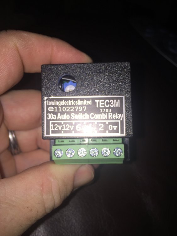

3. As well as the 7 way bypass I had a 30amp Combi Switch relay which says it will "switch to the leisure battery in the caravan if the voltage from the car isn't enough to power it". Has anyone fitted this as im
unsure on how and where to install this.
