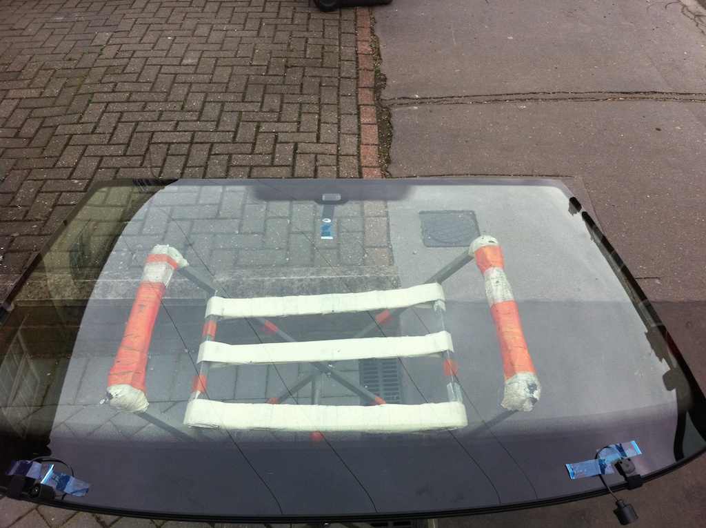

The connections for the heated screen are at the bottom on either side.
That said, does the a/c always stay 'off' at <4degC, even if you have selected windscreen demist?
I don't know, but my feeling from all of last winter was that with the distribution to "full screen" and the fan on then it was working.
Is that really a Yeti Windscreen? It looks too square.
Isn't that because of the large area of darkened glass at the screen bottom that we can't normally see? ;)
On reflection (pardon the pun :giggle: ) I agree. :thumbup:
As Mike has stated wiring connection seems to be at the bottom.
