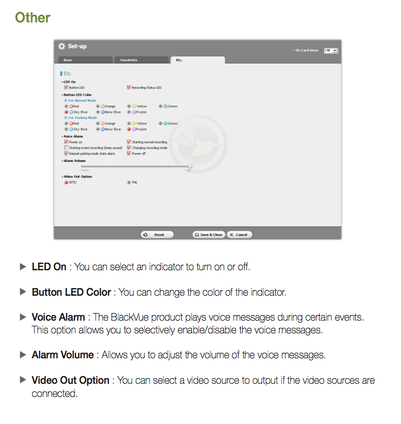

Just as a note for the BlackVue's, i've got the SD in the rear, and the HD in the front.
In the Windows (boo!) based menu / Software, you can turn off the lights. - no need to tape them up! - Mine are turned off! - Only the GPS and Recording lights remain.
Thanks for the tip. :thumbup:

The light now stays turned off - there was issues with the original firmware, but the latest firmware seems to be OK.

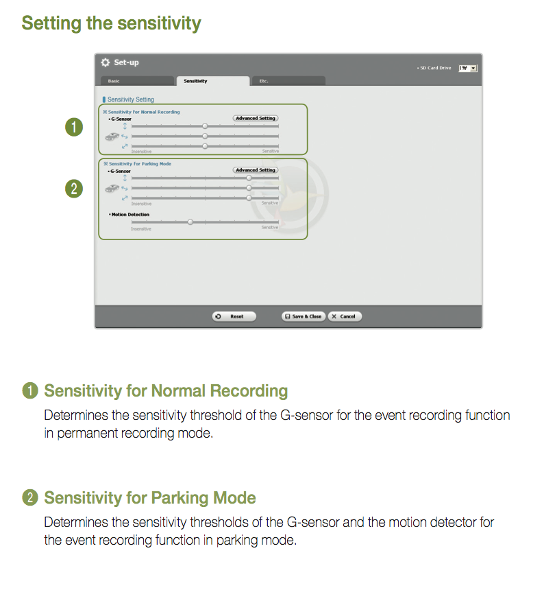

Each Drive Recorder has a GPS sensor and a motion sensor as you suggest.
On each model you can set up the sensitivity of the unit.
When driving it records all the time. When you park it senses no movement and goes into parking mode, which draws less power and only records for about a minute when it senses a bump.

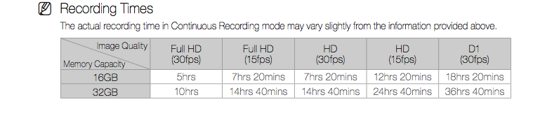

yes when mini SD card is full-DR400 supports up to 32gb, it then overwrites the oldest info. A 32gb card. Can last 2-3 days depending on usage, less if driven lots.
DR400 comes with 16gb mini SD card.
You can alter the settings do that it only records events sensed by its accelerator sensor, which means it would last for longer, and you can also change it to not overwrite should you so wish.

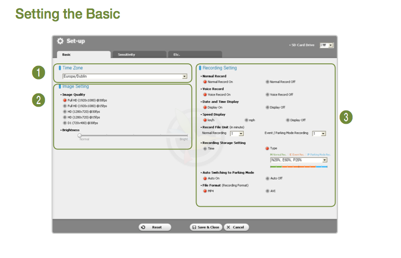

The DR400 manual is to big to upload to this site, but here are some snippets:
Camera 2,073,600pixels CMOS sensor,
Megapixel IR lens
Angle of View 120¾(diagonal), 98¾(horizontal), 55¾(vertical)
Resolution Full HD (1920x1080) @30fps
Full HD (1920x1080) @15fps
HD (1280x720) @30fps
HD (1280x720) @15fps
D1 (720x480) @30fps
Compression Video : H.264, Audio : AAC LC
G-sensor Built-in
GPS Built-in
Microphone Built-in
Speaker Built-in
LED Recording status, GPS, Button
Memory Micro SD card (up to 32GB)
Battery Internal Battery 130mA
Temperature -20¾C ~ 70¾C
Input Voltage 12V ~ 24V DC
Power Consumption Max 3W
Video Out Composite (NTSC/PAL)
Color, Size, Weight Dark Silver, 102.8x32.0 (Dx?mm), 86g
Certification KC, FCC, CE
