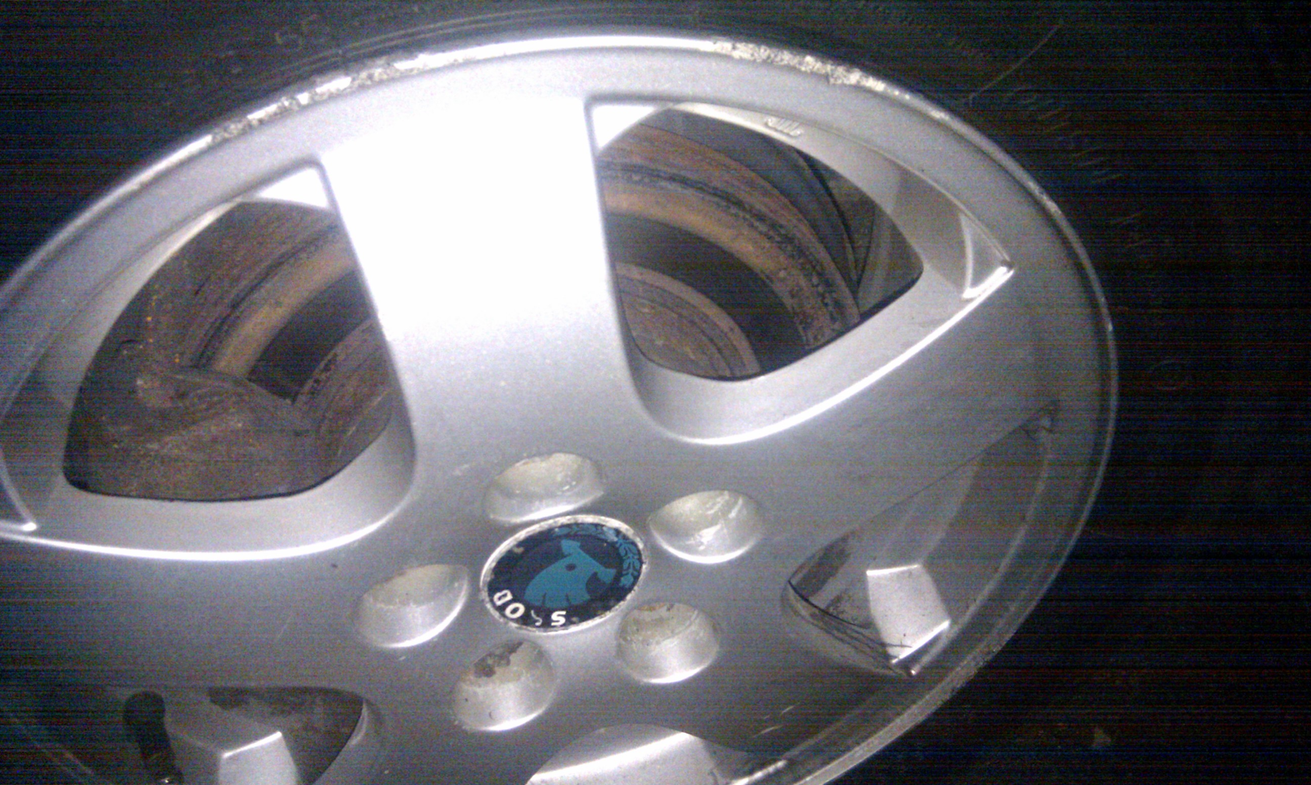

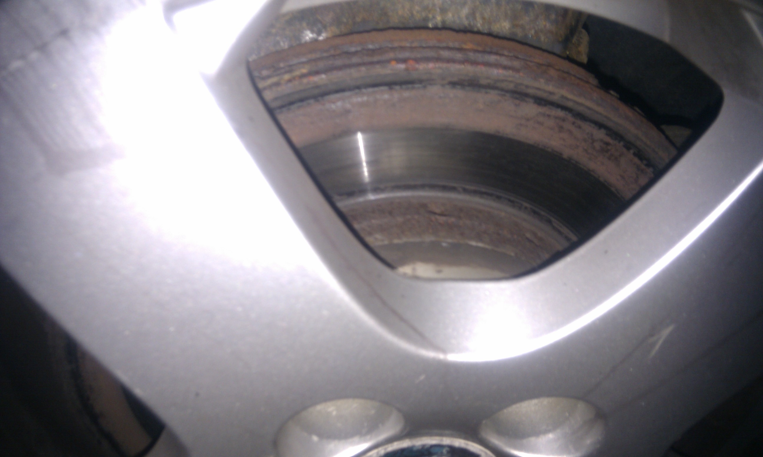

How in God's name did this pass an MOT
Take a look at these pictures. This car passed an MOT in the last 7 days!
Both front discs are like this.
Jesus they dont look too great
I've seen cleaner disks failed, that's for sure. Even if they pass the braking effort test they to my mind they're excessively corroded.

Yes, its the Fabia we picked up last night with a new mot.
Much fuss was made about it being valeted, the seats clearly had been cos they were damp, yet there was two pine cones and assorted other carp under the passenger seat.
A good wirebrushing would help, but really they need replacing.
Looks like they've been on since the car was new. :o
Yeah, I thought that when I saw them. Can't be that expensive?

Tbh for the cost and simplicity of the job, if you're in any doubt, replace them.
I usually source my own parts and just pay to have them fitted.
I'd expect to pay about an hour and a half labour for fitting.
Mintex discs and pads delivered for under £60
I don't do much on cars but discs and pads I do myself. Good link though, cheers :thumbup:
If I worked in sales and marketing that would be "an Iron oxide protective coating to improve the longevity of the disc".
Still they do say the most economical way to drive is as if your brakes have failed so you'll probably save a fortune on fuel emoticon-0136-giggle.gif

If it was me personally I'd run it though another MOT check at a decent garage just to make sure it was done correctly last time.
If you just bought it any other faults would show up and the garage you bought it off should fix it... or you report them for issuing dodgy MOTs. (they hate this)
Worth £40 IMO.
AFAIK it wont fail an MOT on corrosion on the disks, they have to be excessively worn (usually will have a noticeable lip) or below efficiency. My best mate was a qualified MOT tester and most things should actually be pass and advise. I would check with him but I'm pretty sure in this situation the corrosion would have been pass and advise if the braking power was up to scratch.
Carl.
Corrosion was a fail but they have removed it now
That's interesting, when did that happen?
Before March. My car passed it's MOT with quite a bit of corrosion on one of the rear discs.
So "pitting" isn't a fail now then?
The Octy failed its MOT with very light (in my mind) pitting about two years ago.
I've put the reg into Euro car parts and they are listing 256mm and 239mm front disks as well as the 288mm which as we've already said are for the vRS. Guess I'll have to find out the engine code and look up in a Haynes manual?
