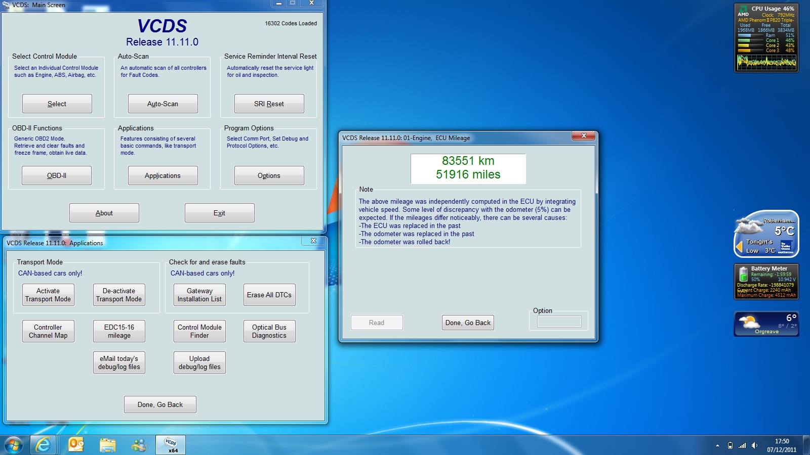

HI, Hopefully someone on here can help me out please. I have had a long standing disagreement with the supplying Franchised deealer of my octy. When i received the V5 it showed on there that they had a recorded mileage of 27000 mile as of october 2009, I bought the car in Dec 2010 with the odometer showing 24500. I raised this immediately with the general manager who told me not to worry as DVLA have not got a clue what they are doing, BUT he would instigate a VMC for me. To this day i have not received a conclusion to this issue despite regularly chasing up. All i ever get is don't worry it's genuine. In Oct of this year i got through the post a letter from a firm of solicitors in Leeds basicly asking why I was the registered keeper of a car that did not belong to me. They went on to say that the vehicle, which i paid cash for, was still subject to an outstanding finance agreement with a balance of £11400. In the course of trying to sort this out, i have again taken up the clocking fight. I was told that it is possible to read the eprom? via VCDS to find the true mileage of the car as shown on: http://www.ross-tech.com/vcds/tour/EDC-15-Mileage.html. This shows that the recorded mileage in the ECU is very slightly under 52000, the odometer is now showing just over 33000. I took my car along to a different Skoda agent and requested that they read and verify the mileage for me. The software they use according to the tech i spoke to does not read to the 'depth' of VCDS and as such the only mileage reading he can obtain matches the odometer. If as i think it will, this case ends up in the county court, will VCDS be accepted as evidence over the dealers Skoda software output? The point of all this is how do i verify that the reading obtained by VCDS is true, in other words i need to be able to prove to the dealer or trading standards etc that the reading from VCDS is the 100% true mileage reading.

It is worth remembering that the mileage that VCDS displays is in KM's, so without working it out exactly looks to be about right.

Right just worked it out, 33,000 miles = 52,600 KM's, so it appears the dealer is correct about the mileage being genuine.
Everyone can now calm down.
Yep, if the ECU said the mileage is 52000 then that ties in with what the odometer says as the ECU stores the mileage in KM.
Oh how i wish it was that easy to explain, however the VCDS shows the readout in both Km and Miles as per the photo i hope i have attached :-)
If the pic doesn't show VCDS shows readings of 83551 Km and 51916 miles.
Ah... Have you presented this to the dealers that you got the car from?
Phil
51916 mi. = 83550.703 km
It could easily be that VCDS reads the km and converts to miles to save the user the trouble. IIRC Uwe Ross is american and they still work in miles, so having a field that does the conversion for you wouldn't be a major programming feat.

The car hasn't been rolled back by only 2500 miles! it has been rolled back by 12 months of motoring PLUS 2500. The reading as per the V5 was 27000 in 2009. I bought the car and took delivery in december 2010 a period of some 14 months between the time of the recorded 27000 and my buying the car. As i say the roll back covers the mileage covered from Oct 2009 to dec 2010 PLUS 2500 miles
The reading from VCDS is independent to the odometer. It is easy to "clock" one of these cars but not so easy to alter the mileage stored in the ECU (which is what VCDS reads).

Am I missing something here?
The speedo says 33,000 miles but the VCDS says 52,000 miles? That's a roll back of 19,000 miles and that's not a small rollback. That's blatant fraud. Have you contacted the police?
Good luck with sorting this out :thumbup:

As others have said, it is easy to 'clock' a car before its first MoT, especially with 20K service intervals nowadays. There is no record anywhere of the mileage of a 2 year old 15k mile car other than at the dealers if it has had warranty work.
The dealer should be able to pull the full history of the car - all warranty and recall work - from the Skoda systems and show you proof of the mileage. In this case, unfortunately, it does look like it has been clocked.
My car is hitting 144K now and VCDS is about 8 miles different to the odometer for reference.
I wouldnt have a clue about the legality of VCDS when used in court but member brucethebear on this forum may be able to answer in more detail.
VCDS ( or VAG-COM) mileage data has been used in a court case as one of the indicators that mileage had been altered.
Mileage and KM are shown in our tool. http://www.ross-tech.com/vcds/tour/EDC-15-Mileage.html Mileage is calculated as the ECU represents all mileage in KM.
Thank s Bear, thats really good to know, am now awaiting a reply from Skoda UK regarding all of this. hopefully it won't need to go to county court.

Hi All, Thanks for all your suggestions and interest in my 'little' problem, I'm now happy to report that A) the finance company concerned have concluded their investigation and whilst they maintain there is finance outstanding, they are satisfied I bought the car as a totally innocent party and as such, whilst still persuing the outstanding amount through 'other channels' they have written to me granting me full title to the car and removing it from the HPI system, although in fairness to the dealer concerned it did show clear on those checks at the time of both their own purchase of the car and also the time of my own purchase.
And B) after meeting finally with someone with some authority today and presenting my VCDS evidence to him I can say no more than the dealership have today been fantastic in the handling of the matter regarding the rollback of the odometer,the director's reaction was one of genuine horror and i am 100% satisfied they had no prior knowledge of this in any way. They have agreed to rewind the deal and give me back the purchase price of the car i paid to them 12 months ago. In all honesty it's what i hoped for but daren't even dream off, I sit here now one very relieved skoda customer. Now what to buy next Octy or Superb? And yes i'm very happy to buy my replacement car from the same dealership, so convinced am i in their position of innocence regarding prior knowledge of either the finance issue or the clocking.
