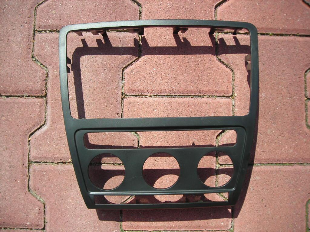

You may want to check the fascia - i highly doubt it will fit as the Bolero in the Octy is different to every other VAG head unit. You may need to buy a new fascia (columbus one) which is about £35.
Notice how the bolero tapers down...

I have to admit that I had missed the difference in shape of the front panels! does anyone know the part no. for the Colombus type fascia panel in piano black finish for L&K?

THE MATT BLACK ONE IS 1zo858069A
Yep i missed that when i got my columbus! Had a nice gap around the nav for a few weeks until i got round to getting one. It simply unclips bottom up from below the climate unit.
