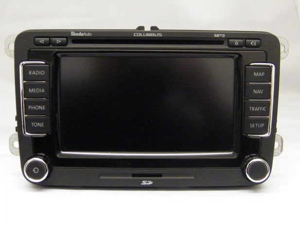

Ok great. So the next question is how do you pull the Columbus out to plug the lead in to the back of it?
You will have to remove the surround of the head unit to find the 4 torx screws to remove it.
Here you can see where they are located (the ears on the head unit :) )

What I found, is that the superb can have two versions of the columbus.
One as posted here, and there is a version with wider buttons. They have to be removed differently, as you can see in the manual below:
http://www.fiscon-mobile.de/support/manual_superb_3t.php
Only problem is the head units in the photos are NOT a Columbus. They are Bolero units which were updated sometime at the beginning of 2011 I think, hence the 2 versions. The picture in the web page header is of a Columbus and they have 4 buttons each side, the bottom left button being for 'TONE and not 'PHONE'. The Bolero has always had 3 buttons each side, with the lower left button being 'PHONE' as in the photos. In the top photo you can actually read the head unit name.
Oops didnt look that far, my mistake.
Knew about the two versions of the bolero and thought the Columbus might have been changed too.
Dont have my Octavia anymore, so I am not that up to date. ;)
