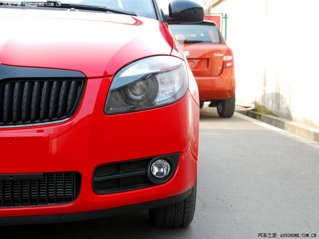

After that I decided it was time to Montify my headlights. After some tests I realized that the Skoda originals couldn't not be opened the easy way - only way was by breaking them or cutting them and that would have been expensive and overall not a smart move in the long run. So I got myself a set of Depos which with a heat-gun were very easy to open. Shame I don't have photos of the process - didn't think of documenting the whole thing but after a lot of hard work the result was good enough for me. It could have been perfect but being this my first DIY I shouldn't complain.

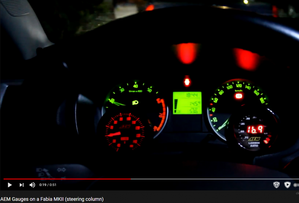

The latest changes or better additions to the car are two instruments (water temp and Wideband) that I installed on after a lot of research on the steering column.
The pods are from Craven Speed. http://www.cravenspeed.com/products/The-Belmont.html

Thats a great looking Fabia! Do you happen to have a "how to" for the headlights? I'd like to do the same.
Great stuff! :thumbup:
Just seen a post no worries about the lights, but are they aftermarket lights that look OEM? I've seen chinese ones too....
So glad you changed the alloys to the new vrs ones! One very good looking Fabia Sport! :)
Thanks for the comments guys,  yes indeed the vRS alloys are the best looking alloys for the Fabia in my opinion. Really suit the car and I couldn't be more pleased.
Great stuff!
Yes they are aftermarket - the company that makes them is called DEPO and can be found on ebay but I'm sure there will be a shop in your area that stocks them. They are half the price, in some cases cheaper. The original Skoda ones (well really they are Hella) are a bitch to open. Ultimately you will have to either brake them or cut them at the seams to open them up and that would be a big no no in the long run. Condensation in the headlight etc. The DEPO ones can be easily opened because the insulating silicone can be heated up and soften with a heat gun thus making the whole process of separating the headlamp very easy. You then need to unscrew and take out carefully all the bits of chrome, paint them and then reverse the process in order to finish your mod. I took also the extra precaution of adding extra silicon where the back and front meet especially on the top. Didn't notice any problems yet and make sure when you are modding that you keep the glass bit clean from the inside ie do not touch it and cover it from dust cause the moment you try to clean the inside it will never be perfect. I learned the hard way
By the way the DEPO headlights function fine even for aftermarkets and didn't have any problems until now. Looks and quality? you can't tell the difference from the Hella ones except of some bits on the back and inside mechanism but other then that they can fool anyone.
Shame I didn't record the process but if I make a set for another friend who is interested I will make sure I do it
Oh one last note - don't paint the all the chrome bits black, well at least I would avoided it. Aesthetically I don't think is the best option and make sure to leave a part of the upper blinker in chrome so the light can be reflected properly. When masking do not use very sticky tape otherwise you will lift off the chrome paint which is very sensitive. In the whole process what I found most difficult was painting the sucker rather putting it together but that has to do with my knowledge in spray painting which is non existent.
Let me know if you need any help with your project.
1325851049[/url]' post='2634614']
Thanks for the comments guys :) yes indeed the vRS alloys are the best looking alloys for the Fabia in my opinion. Really suit the car and I couldn't be more pleased.
Yes they are aftermarket - the company that makes them is called DEPO and can be found on ebay but I'm sure there will be a shop in your area that stocks them. They are half the price, in some cases cheaper. The original Skoda ones (well really they are Hella) are a bitch to open. Ultimately you will have to either brake them or cut them at the seams to open them up and that would be a big no no in the long run. Condensation in the headlight etc. The DEPO ones can be easily opened because the insulating silicone can be heated up and soften with a heat gun thus making the whole process of separating the headlamp very easy. You then need to unscrew and take out carefully all the bits of chrome, paint them and then reverse the process in order to finish your mod. I took also the extra precaution of adding extra silicon where the back and front meet especially on the top. Didn't notice any problems yet and make sure when you are modding that you keep the glass bit clean from the inside ie do not touch it and cover it from dust cause the moment you try to clean the inside it will never be perfect. I learned the hard way :thumbdown:
Shame I didn't record the process but if I make a set for another friend who is interested I will make sure I do it :)
Oh one last note - don't paint the all the chrome bits black, well at least I would avoided it. Aesthetically I don't think is the best option and make sure to leave a part of the upper blinker in chrome so the light can be reflected properly. When masking do not use very sticky tape otherwise you will lift off the chrome paint which is very sensitive. In the whole process what I found most difficult was painting the sucker rather putting it together but that has to do with my knowledge in spray painting which is non existent :giggle:

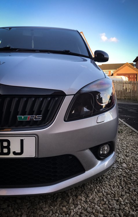

As for the bumper yes, got it the other day and I'm now waiting for it to get painted. The current spoiler I got and which can be seen on my pics broke. I went over a bump at a parking lot which was too high and while going over it I heard I was scrapping the spoiler so I decided to back up spoiler got caught on the bump and the car did the rest and crack! Well anyway I wasn't happy with that particular spoiler as it may look great but it made the car too low giving me trouble many times.
The sport bumper is the best option I think. One thing I don't like with it is that on the sides it looks that it's an add on, stuck on the front of the car but I'm hoping that my car being in black will mute the effect.

Top work buddy! The new OEM bumper lip looks great!
Not sure many people like these stickies but I find them fitting for the Fabia.
Cheers Leon - the bumper is an improvement.
