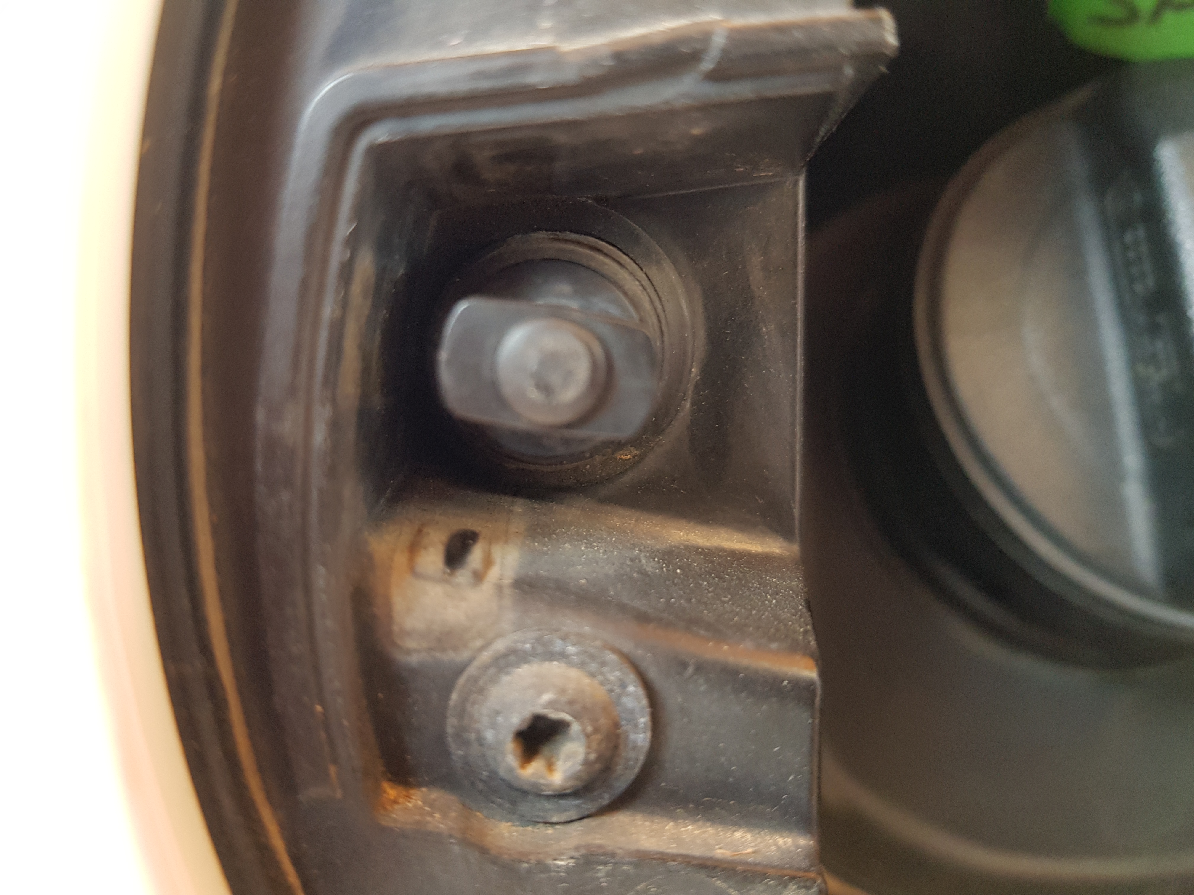

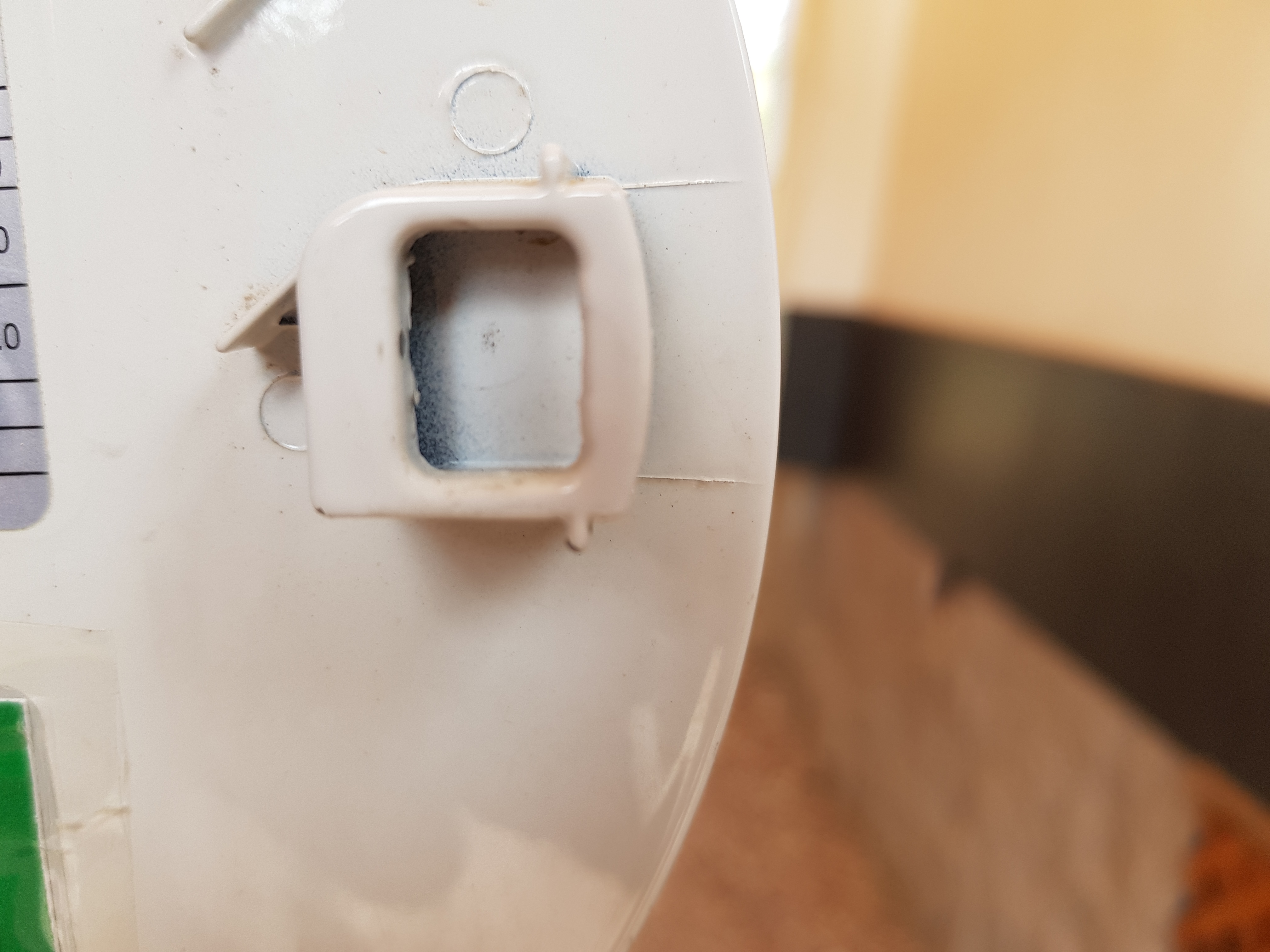

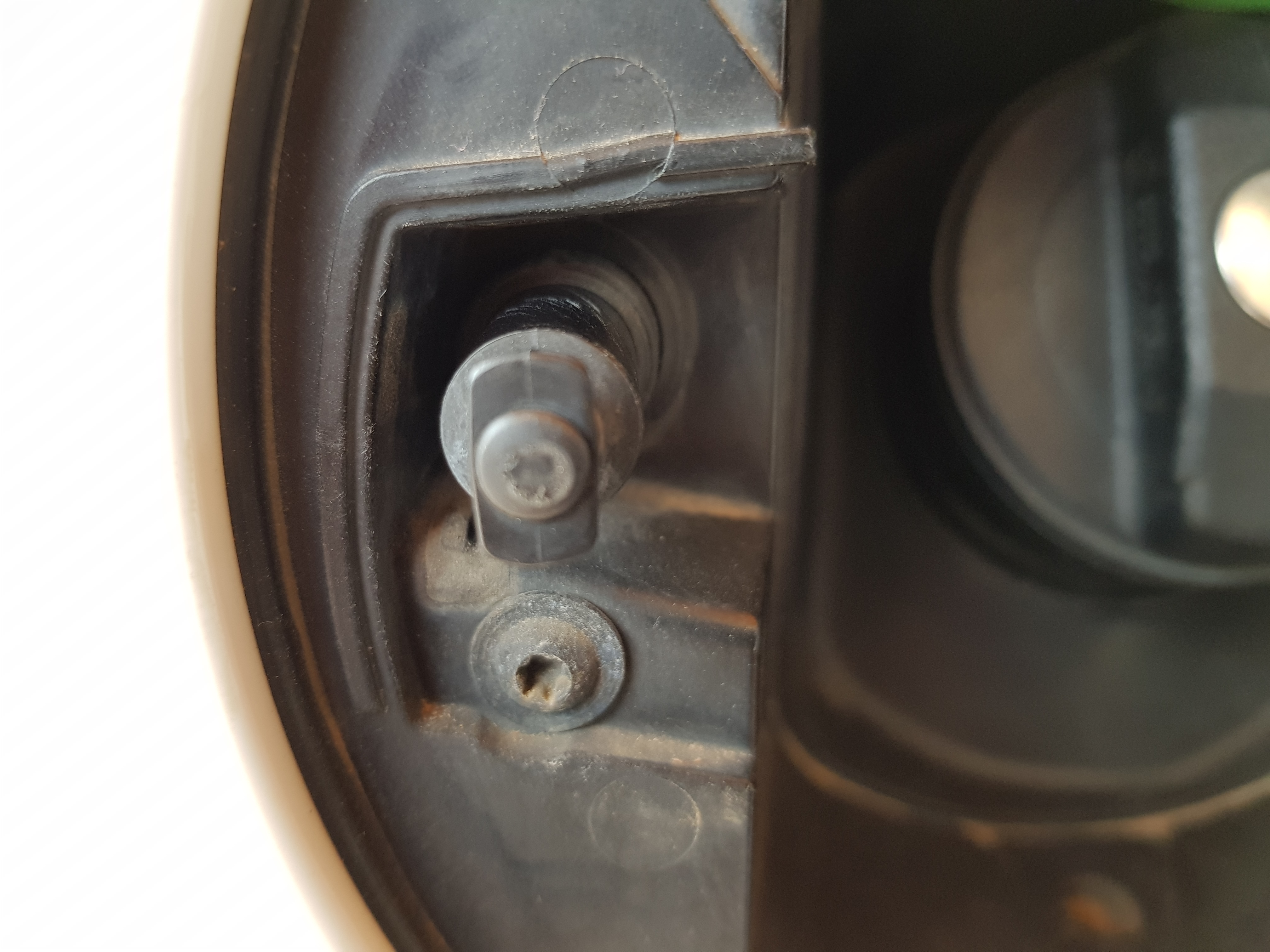

Resurrecting an older topic. I'm having to replace the locking mechanism on mine for the second time - in the last few days the noise coming from the fuel flap when I lock and unlock the car on the remote has changed and I'm not going to wait for it to fail; releasing the stuck flap with brute force and a screwdriver last time wasn't good for the nerves. Interestingly the first one failed in 2019, this one in 2025. As mine is a 2013 car this means for me at least they last about 6 years. It might be interesting if others have found something similar although I appreciate not many people keep the same car as long as I have. List price seems to be about £65 but I found one on eBay that looks identical and although it's not listed for a Yeti it is listed for a lot of VW and SEAT models so worth a try at £20 (new, not used). I've disconnected the wiring whilst I wait for the part to arrive and it's reminded me just how much force you need to pull out the flap and liner.
Update. The part arrived and though not listed for the Yeti was the correct part. Now been fitted and all is well. For anyone with the same problem and tempted to have a go themselves (it really is easy an easy fix) to protect the paintwork whilst levering out the filler flap and liner I used a little plastic spatula used for spreading glue to get between the edge of the liner and the body paintwork and then slid a screwdriver down that to carefully lever out the liner from the lock side. Also a couple of layers of masking tape on the hinge side protected the bodywork against any scuffing from the filler flap as you remove the liner. Simple things but make the job a bit less stressful for the technically challenged.
