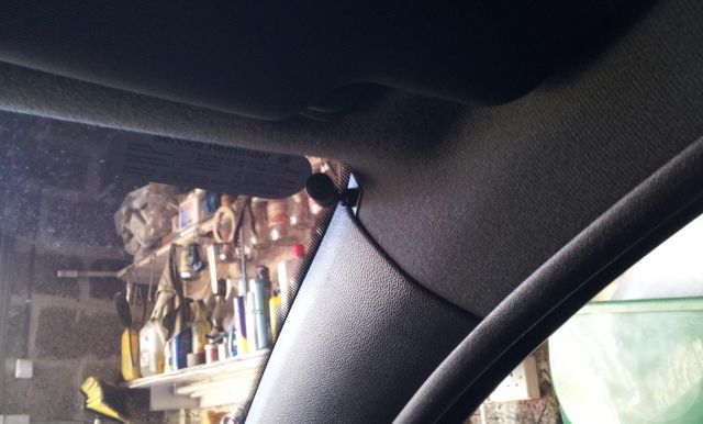

I put the mic. at the top of the A pillar on the drivers side.
I didn't use the mounting clip but wedged the little base plate between the A pillar trim and the headlining.
The cable was nice and long, I routed it behind the glove box, up the passenger side and along the top of the windscreen. I didn't want to route the cable near the steering column and instrumentation as I thought there was too much to break or get in the way.

How dificult is it to route the mic to where it is in your picture? Whats invlolved with routing it behind the glove box too?

might be a bit late now but in case you haven't fitted it yet I recommend:
*taking the glove box out (few screws above and below glovebox opening and unplug light) this will let you route the mic cable and give you restricted access to the side of the headunit (be careful not to "explode" glovebox light- apparently it falls apart easily)
*removing door seal up passenger side of windscreen. This will let you run the mic. cable up to the headlining.
*its also a good idea to remove the vents above the headunit, will enable you to manipulate the cables as you push the headunit into place. also lets you position any ipod adaptors etc in the small space above the headunit.
*finally, manipulate the car loom into bottom left of headunit aperture, routing it behind the plastic support at the back. this stops it getting in the way preventing the headunit going deep enough into the dash. (this assumes that the ISO connectors are in the same place as a 3300BT)
You will need tools to remove the Symphony unit, kenwood tools work, some people make them from junior hacksaw blades.
If you do the above, then routing the mic. cable will be easy. I can't remember but you might have to unclip the top of the A pillar cover trims. This just involves a firm tug into the car, you may be lucky but sometimes the trim comes off but the clip stays in place, then you have to get the clip out and re-fit it to the trim before you put it back together.
