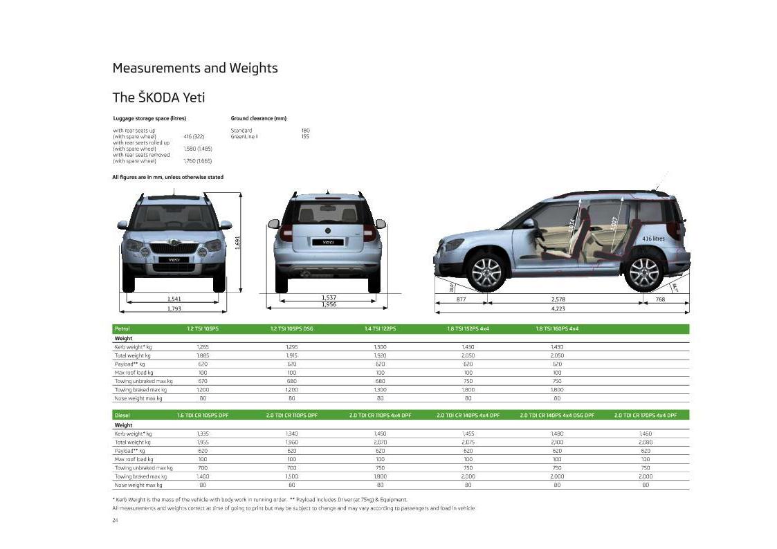

please forgive a minor disagreement - the Jan 2012 figures for the 140 4x4 DSG are given as 1430kg kerb weight, 2000kg max braked trailer.
Actually, the Jan 2012 figures for the 140 4x4 DSG according to SUK's brochure are kerb weight 1480kg and 2000kg max braked trailer. :hi:
Totally my error - didn't spot the typo. I agree 1480kg! That's what I read. Perhaps my brain needs a DSG, too.

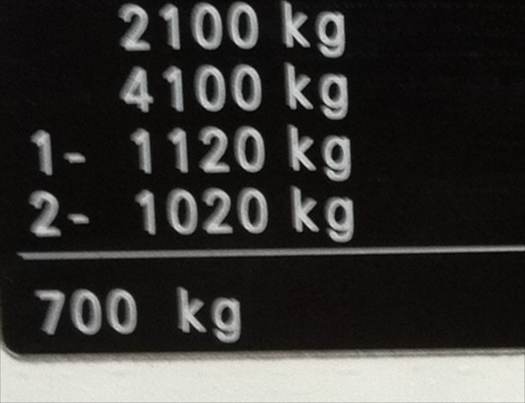

This is what my 4x4 DSG CR140 plate says:

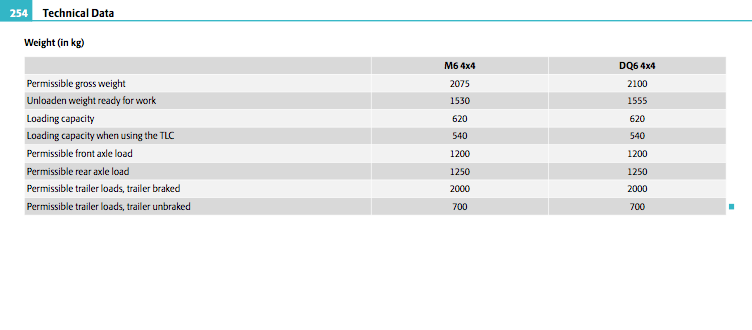

And this is what my manual says:

The relevant towing limits were increased to 2000kg not long after the Yeti was introduced, however that does put the trailer over the vehicle kerb weight. Having done it once with the Freelander, I won't be doing it again!!
I have heard that both the UK Caravan Clubs are considering an increase in the "recommended" limits, and I do feel that the current limit does not take into account the modern systems nowadays found on cars, from anti-lock braking to electronic stability systems. Remeber that the 80% figure was thought up when cars still had drum rear brakes!
