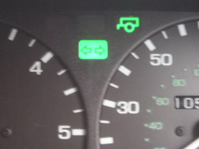

What provision is there for the 'trailer tell-tale' in an Octavia?
Is it an audible device ('buzzer'), or a small icon in the instrument panel??
As an aside to this, all of my previous Landies (barring the first one; a 1969 2A) had a little trailer icon in a dial, the attached pciture shows it on my old Discovery (300TDi)
If the car is ordered from the factory with the tow bar preparation (specially adopted wiring loom to the back of the car), the tow bar is fitted and wired up correctly and finally it is coded properly to the CANBUS then there should also be a light that flashes on the dash to show that the indicators are working just like your Landy (rear parking sensors and the rear fog lights are disabled too when something is hooked up).
The problem is to get all three of the above steps completed above is a rarity.
My Octavia has the old style buzzer in the boot somewhere.
Thanks for that 'silver'
I just wondered as some manufacturers seem to have disregarded this point entirely
