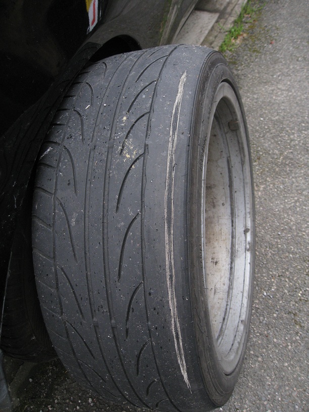

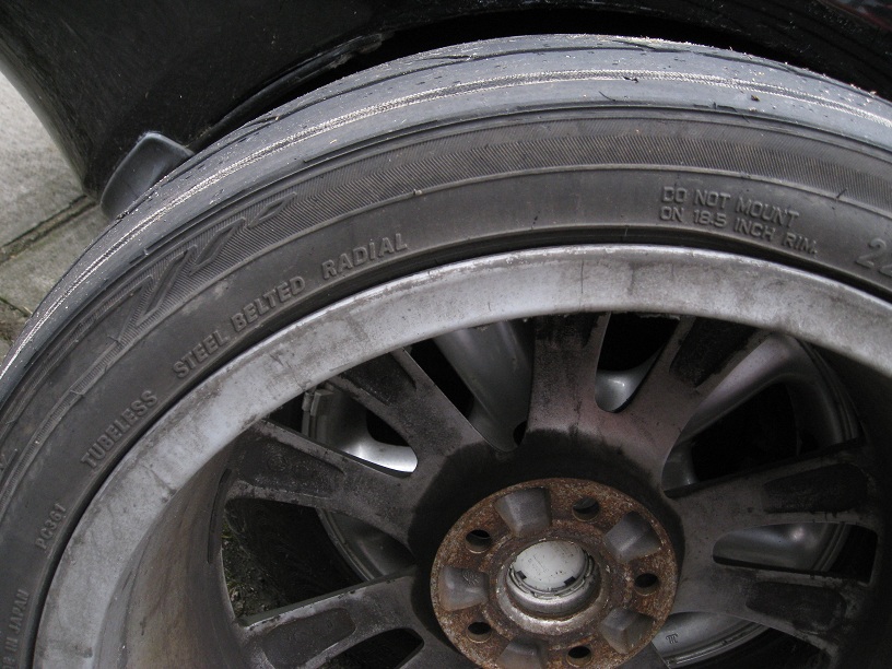

Another sufferer here. I've had a few tyres now that have caught me by surprise like this. My local independant garage didn't seem to know anything about getting tracking checked last time they found this, only saying that they were very susceptible to pressures.
I've put a couple of pictures up of how they've finished up, but one interesting thing is at the point where the wear is worst, the tyre bead seems to have been pulled in, and the tyre is distorted. The wheel doesn't seem to be out of shape though.
I am definitely going to get the alignment sorted now, so any recommendations for someone in the Reading area would be gratefully received.
Had mine checked at Protyres in Blandford after I'd read a fair bit on here about this problem. Both rears were running with over 2 degrees of negative camber.
