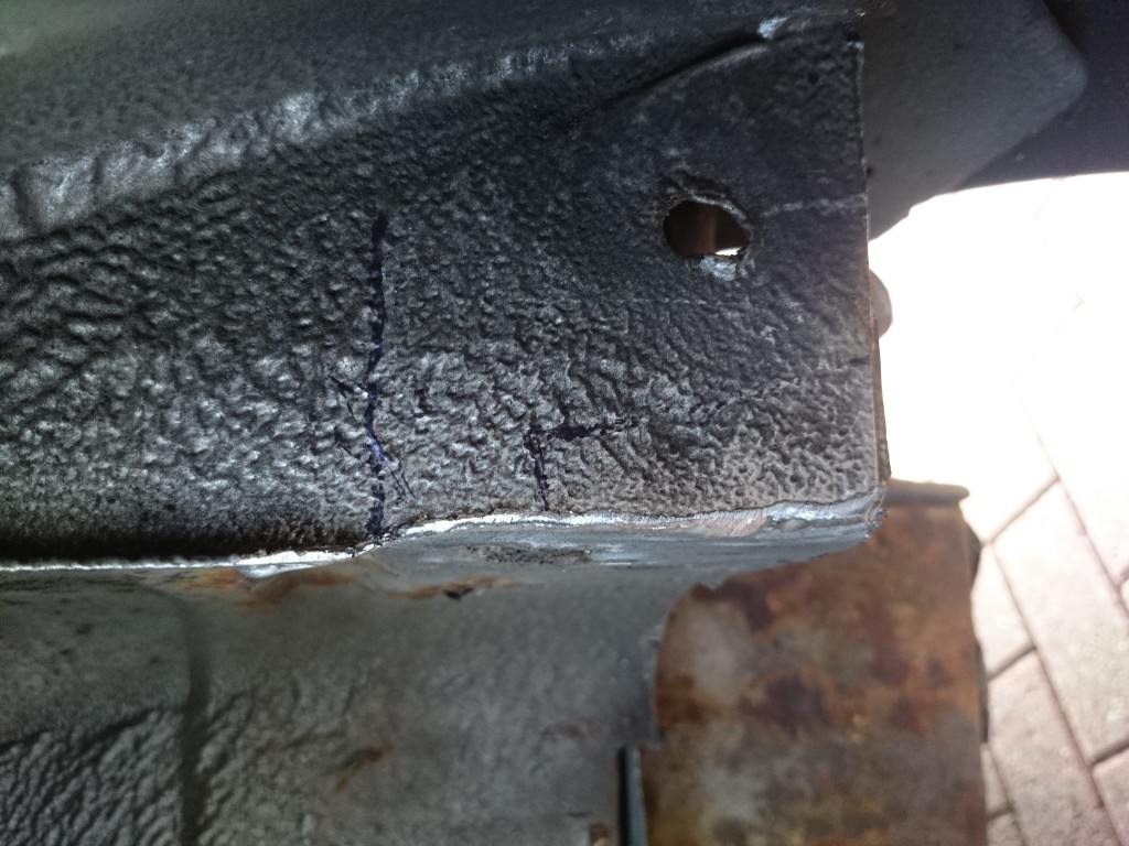

you say the speedo is miles out, i have some big ass tyres on my car 195/65/15 and the speedo is spot on according to satnav, the rubbing on the rear arch was sorted with the aid of a angle grinder and removing 5mm of the little lip, which was chemical rust treated and painted and undersealed, filling the back of the car up with gravel and concrete slabs and a fat man jumping up and down there was plenty of clearance once the plastic wheel arch liner has warn through

piccy, also cleaned up the rusty spots whilst i was under there
