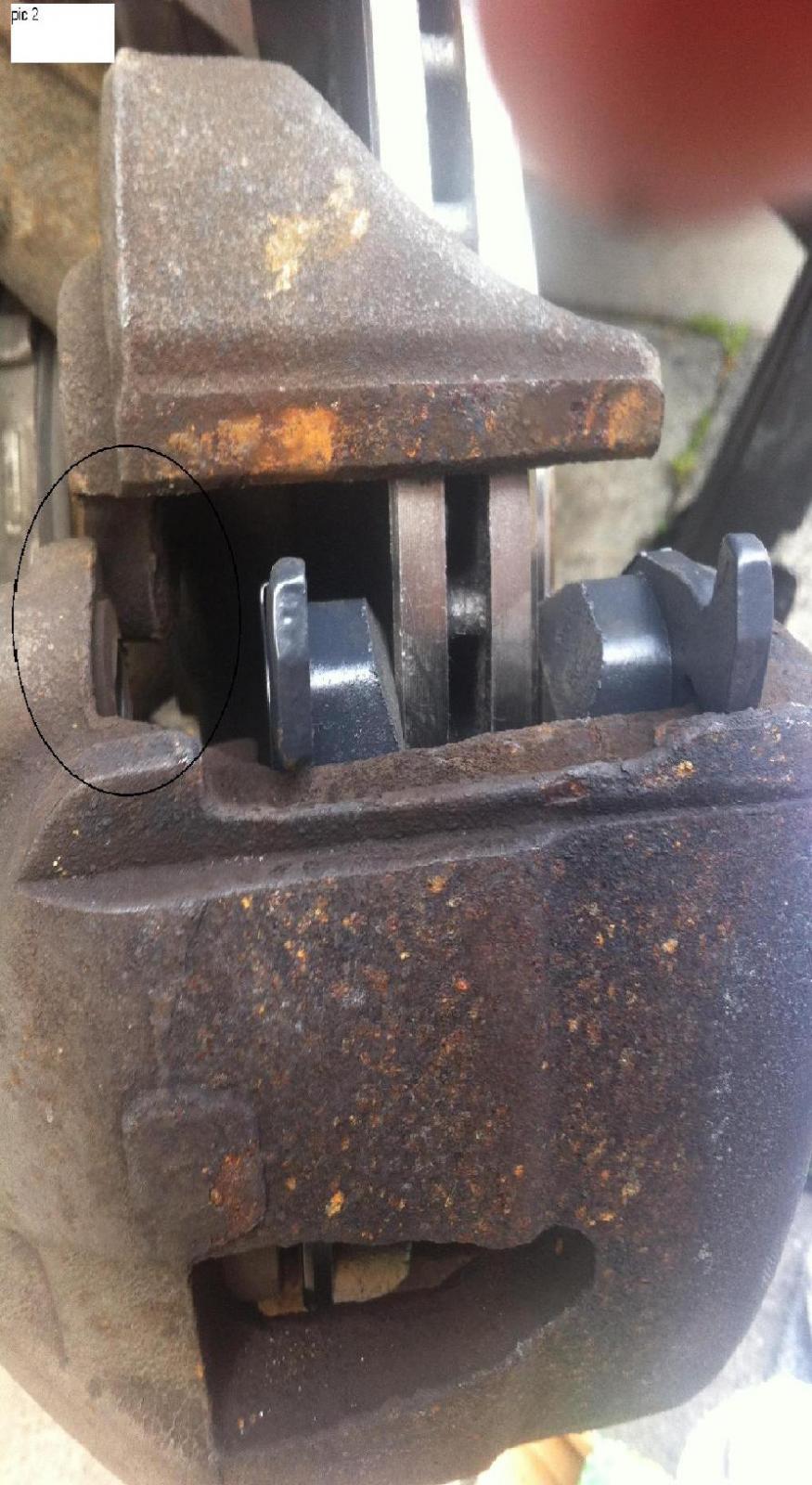

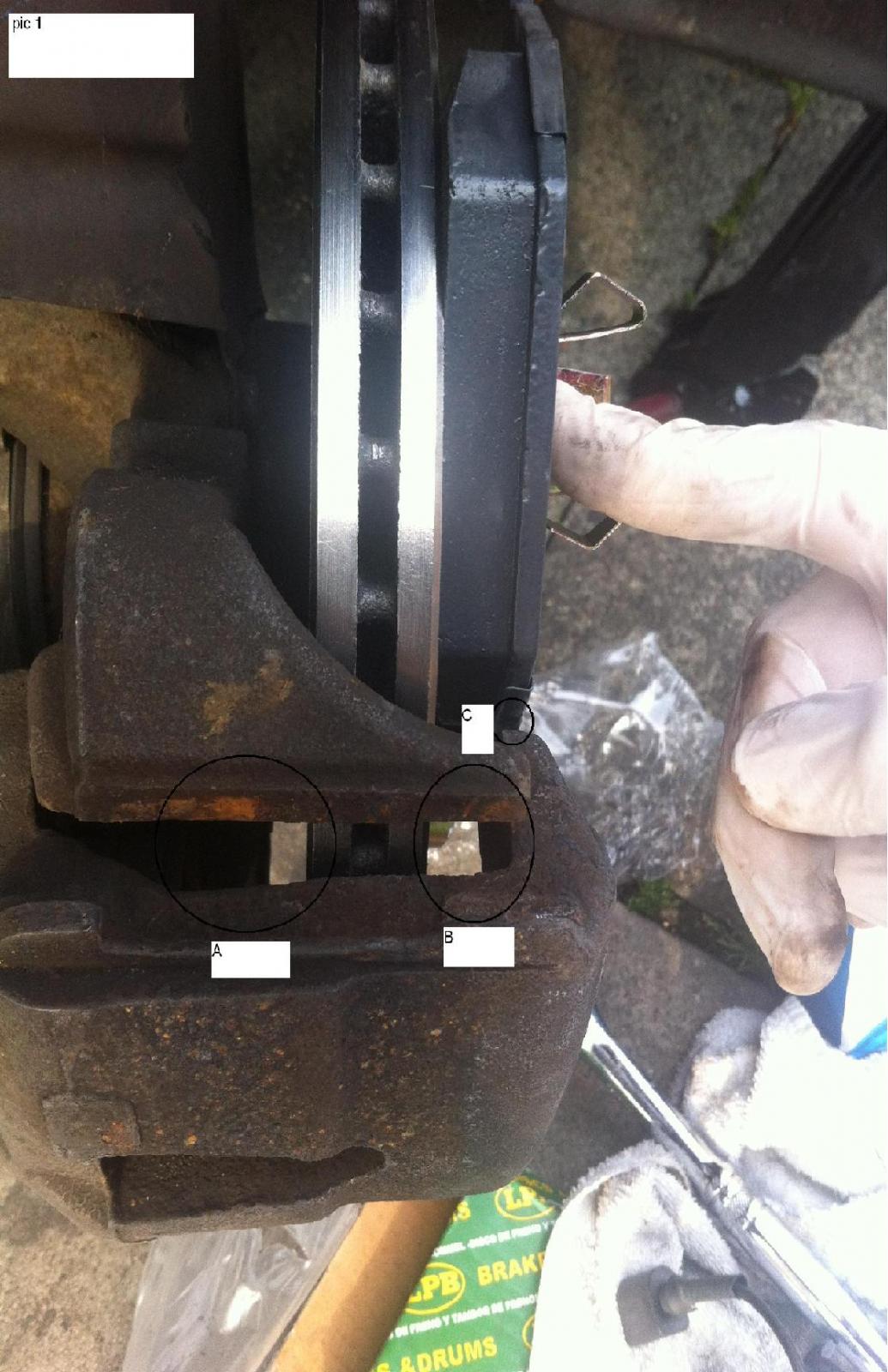

if you look at pic1 youl see the caliper is bolted to the hanger and the space for the pad on the side of the disk away from the piston is smaller than the thickness of the pad therefor i cant get the pad in

If you haven't already fixed this. Unbolt the caliper from the mount, fit the pads in the caliper then offer it up to the disk. It should be obvious what is the problem, probably the sleeves that the guide pins run in are protruding.
Ye if you look at the pics i uploaded youl see what i mean
If the guides are protruding push them into the caliper
Maybe I'm wrong, but it looks like the "height" of that disc is wrong - maybe check that disc or discs against what you have taken off - its the "top hat" dimension I'm referring to.

Or, that piston is not fully retracted.

Did you check the disc against the old one before you fitted it? It could be the wrong bake disc by the looks of it, I take it those are 256mm discs right?
but he got one side on alright-2 discs, different sizes in the same box????!!!!!!!!!!
Ye one side fitted perfectly without any problems ive even tried another set of disks just the pas side is giving problems
Its not the sliders
I just dont get it without any pads in with the caliper bolted on as it should be as you can se in the pic that the space eather side of the disk where the pads should be is diffrent the side where the piston is has liads of space for the pad thats not the problem but look at the opposate side of the disk where the other pad should go the gap between the disk and the outer of the caliper is not wide enough to fit the second pad in and i just cant figure out why
