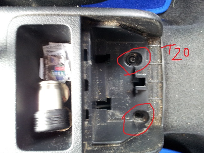

Firstly remove the rear cup-holder to reveal two t20 torx screws and remove them

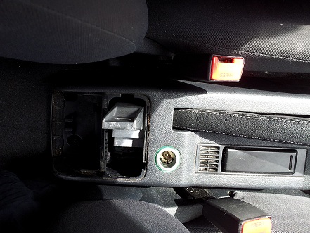

then you can lift and remove the surround sliding it up the handbrake and removing clip on lighter socket.

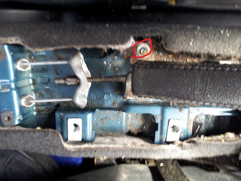

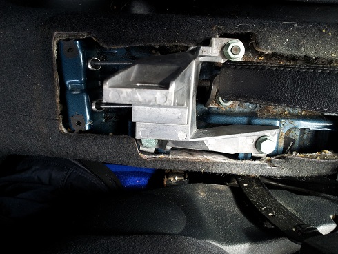

Then slide on the two captive nuts and remove the circled handbrake nut as you should have a nut with a threaded shaft on to replace it with

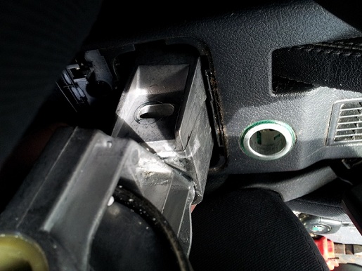

Then bolt on mount. you may need to cut some away for lighter socket as will sit a little higher when in place but i didnt
Then refit surround

You will now be left with the plastic trim that fits the sides which will need to be modified to fit and you will also loose use of the rear cup holder

Nice shot of the handbrake adjuster yoke as well, I may be nicking that in future when people ask about adjusting their handbrakes :thumbup:
