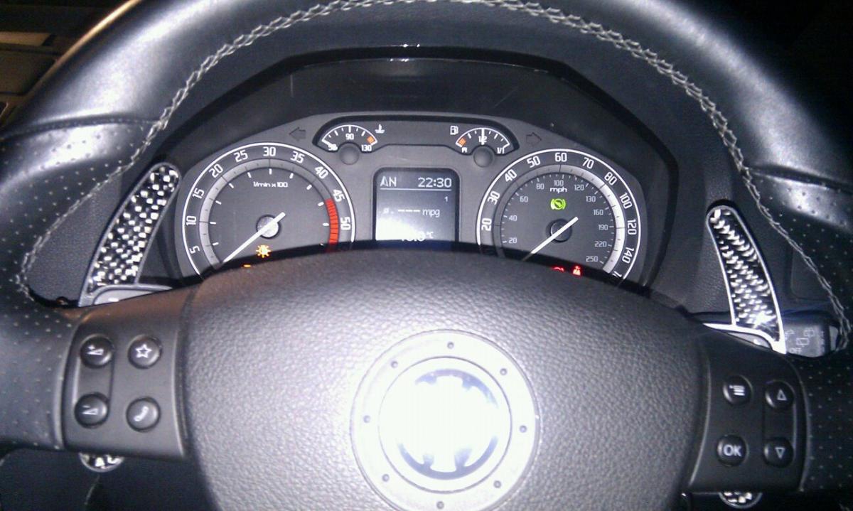

DSG paddle extensions..........now fitted
  • Replies 50
  • Views 11.8k
  • And fitted.........
  • Thats a good find. Think ill order some of these as well
  • I got them for function over form TBH When I’m concentrating on the road I’m not really bothered how pretty they look Having driven the car this morning, I can honestly say it is amazing how much

And fitted.........
I like Carls Titanium lookalike ones , I have Titanium shifters on my bike. Bryan get your bulb fixed :giggle:
Carl are the OSIR paddle extensions easy to fit ??
Thanks.
Well done for fitting them, but I don't like them.
Seems odd you can still see the original paddles. I know it's a more expensive and awkward fit but I would say removing and replacing the original would look best.
Having driven the car this morning, I can honestly say it is amazing how much more inclined I am to use the car manually with these fitted - £30 very well spent
Thanks.
Yes - took me literally 15 mins to do. Very easy on the FL. It is just a case of
Remove Airbag
Remove Paddles
Seperate plastic cover from paddle internals
Fix OSIR paddle to internals
Refit Paddles
Refit Airbag
Job done.

Hey Bryan - 6 months on..... how are these DSG paddle extensions holding up?
I might be in the market for some.... :thumbup:
Cheers,
Ste.
just fitted mine. not used yet but looks good.
Cheers,
Ste.
Absolutely fine, no issues whatsoever :-)
Having said that, I still drive quite rarely in manual mode because the DSG is so good
Cheers for the feedback. Currently £24.95 delivered..... worth a trial i think! :thumbup:
