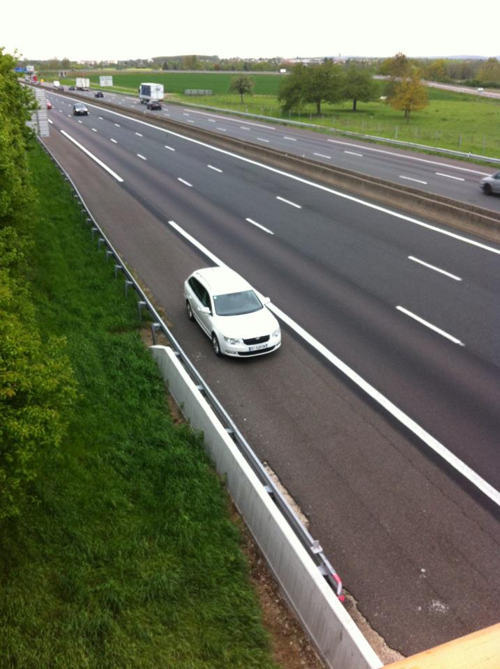

Had my first service carried out on wednesday morning (30 000km - got the car on 12/09/2011) and whilst driving on the motorway approx 2 1/2 hrs later, the oil pressure light came on and so stopped the car straight away.
By the time I got back from the orange "SOS" box on the side of the motorway, I noticed a nice puddle of oil under my car... hmmmmm....
