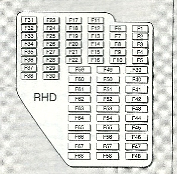

In the Book of St. Haynes chapter 12 .21 Power Steering is fuse F7 and it should be 5A BUT it says F7 5A Engine electronics, power steering so not sure what else won't work if you pull that fuse. This is from Haynes for Skoda Fabia MkI.
F7 is located second row from the right, second fuse down

If you actually need to disable it the pump is situated behind the front p/s fog light and it should be a case of unplugging the connector, you could also remove the fuse in the top of the battery cover and that would do the same job.

one of the flat metal blade fuses on the top of the battery will do the job. you need 8 or 10mm socket to unscrew the wire or remove the fuse

I'm getting a squealing noise on right turns when accelerating (it's hard to describe but sounds like a slipping belt) and would like to rule out the PAS by disabling the pump temporarily just to go for a quick test drive (the problem will be evident within a few seconds and then I can turn it back on). Does anyone have any idea what would happen if I removed fuse 7 from the fuseboard? That would be the quickest, easiest to reverse change, I don't want to be crawling at the side of the road trying to get the connectors back on the pump if I can help it, part of my passenger foglight grille is blocked by the numberplate so access may not be as easy as it could be. Ta!
