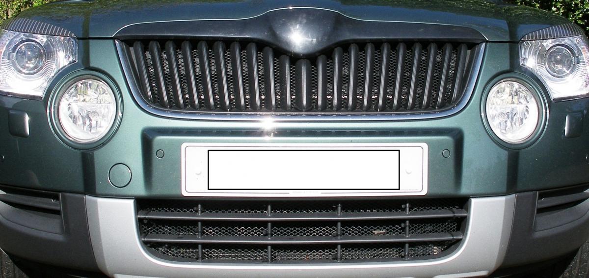

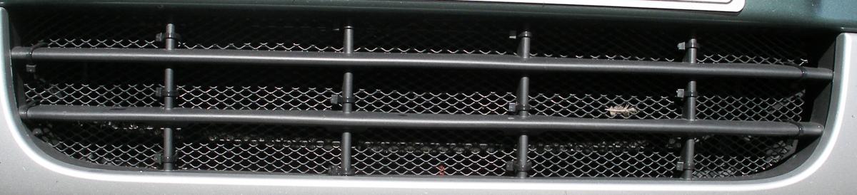

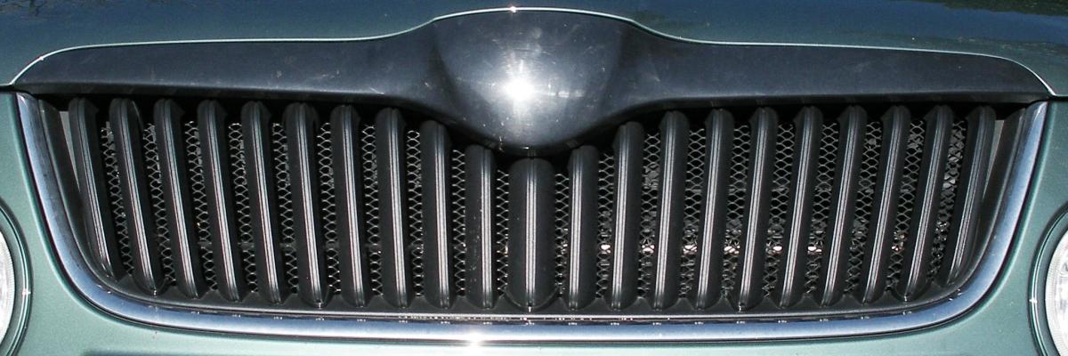

I used a single sheet of Aluminium Black Mesh at a total cost of £15.95 (http://cgi.ebay.co.u...#ht_5867wt_1185 ) to provide both upper and lower grille protection, secured with black cable ties. T'was a bit fiddly getting the mesh behind the main grilles, but no more so than upgrading the drls. :giggle: :giggle:
I'm pleased with the end result and am sure it will help reduce potential problems over the period.

I used a single sheet of Aluminium Black Mesh at a total cost of £15.95 (http://cgi.ebay.co.u...#ht_5867wt_1185 )to provide both upper and lower grille protection, secured with black cable ties. T'was a bit fiddly getting the mesh behind the main grilles, but no more so than upgrading the drls. :giggle: :giggle:
I think this looks better than mine. The mesh I used was cheaper galvanized but it did need painting. Removing the silver part of the bumper is really just brute force. a sharp yank. Look underneath and you will see the bottom clips that can eased off.
