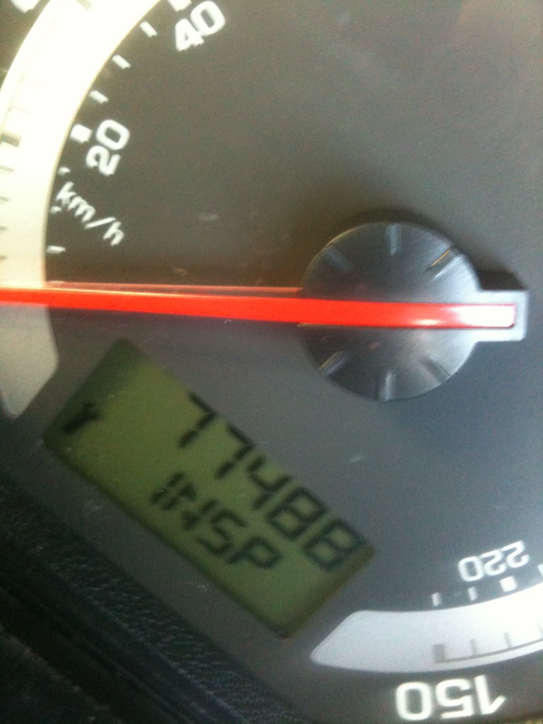

What does this mean?
I'm hoping it just means it needs a service and nothing severe?
Yep it's auto matic, it's either set to monthly intervals or mileage. You re set it using one of the stalks
Looks like the service indicator light mate.....better get it booked in :happy:
To reset hold the clock reset button then turn ignition to on and hold for ten seconds until it clears :)
I wouldve guessed it was short for inspection, do you have an owners manual?
