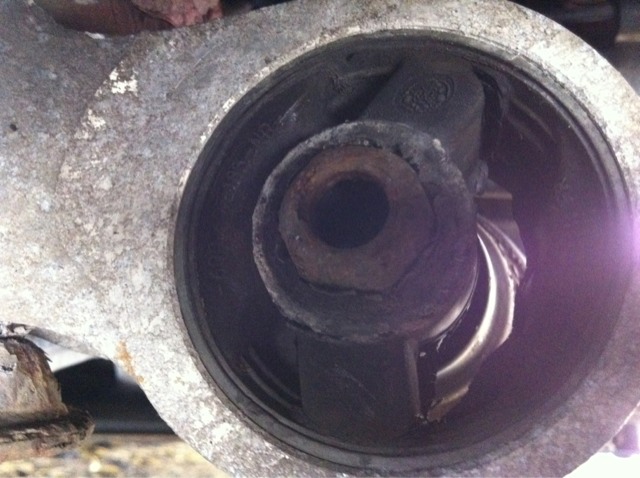

I went for Powerflex because they are a two part bush, require no special tools to fit and change what most describe as a PITA job into a quick and easy one. They also have a lifetime guarantee which considering he number of people who've had to replace OE bushes more than once goes a long way with me, they don't squeek, they don't vibrate, in fact they are no different for me than oe appart from they work :) Cost wise £47ish from memory from Demon Tweaks via ebay and they arrived next day. To give you some idea of what you're looking for here's a photo of my console bush on the drivers side...
The front bush will probably be fine, the rear will normally be knackered, that image shows the tears top and bottom quite clearly but that's on full lock. While you're at it you could have a look at the drop links as they tend to come up regularly as causing issues, they're very to replace at the same time.
