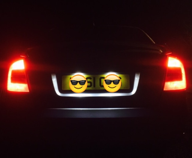

  • Right the W5W (501) holders arrived today. First they cables were shortened: Then they were soldered to the number plate lights: Then cable tied to the light: Fitted to the car: Comparison
