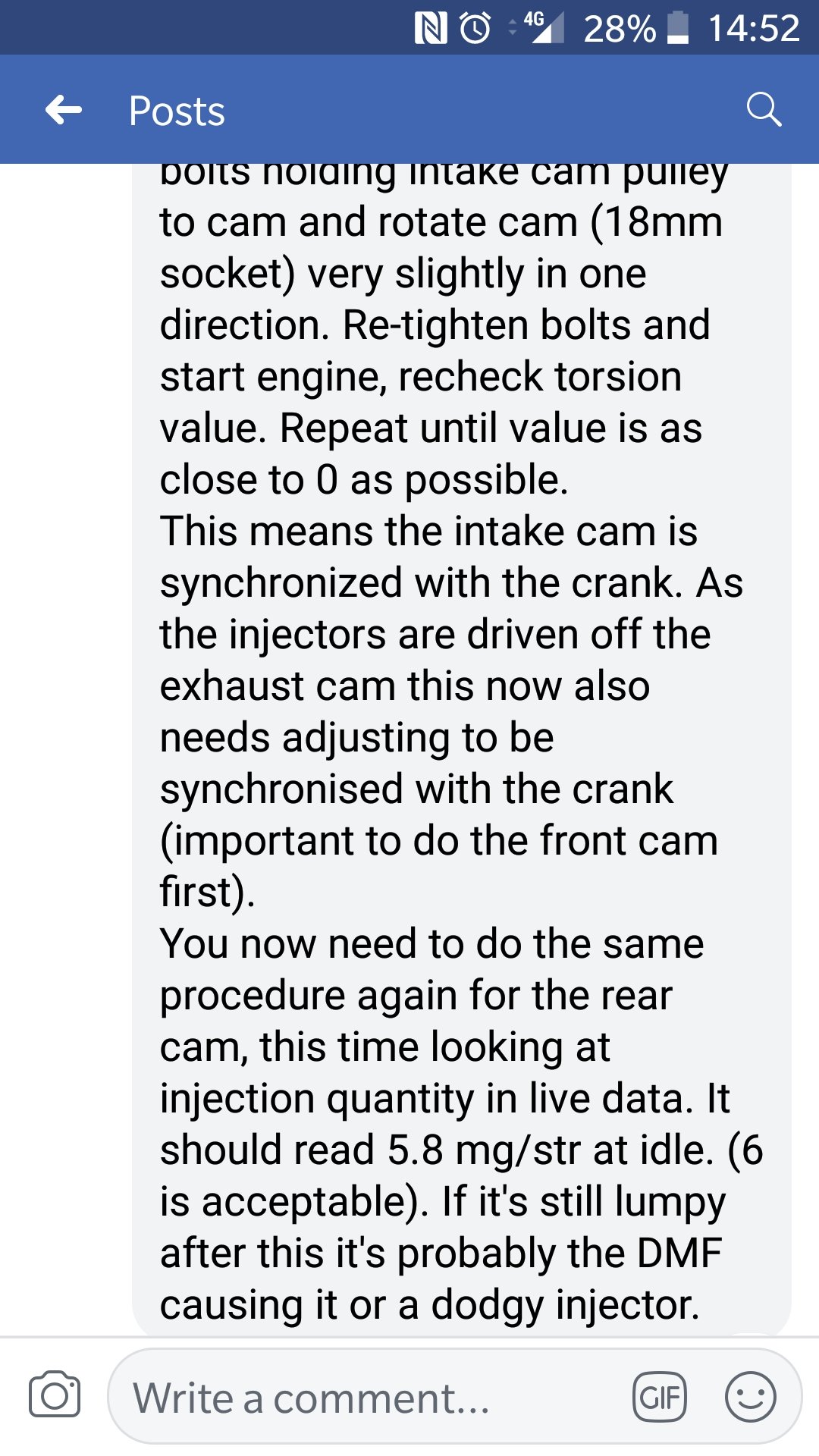

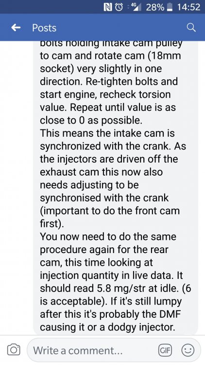

Right I'm going to just leave this here as I struggled to find the right info regarding my ruff idle and white smoke when warming up. Front cam needs adjusting to the torsion value of 0 using vagcom or vcds.. rear now needs adjustment but now looking at injection timing and should be 5.8

Hello guys, I'm a new member of this forum and I have the very same problems with my golf 5 gt 2.0tdi 170 ps.  My front cam was with torsion value from 2.30 and i successfully adjusted to 0.35.
I also moved a little the exhaust cam. My smokey problems and this juggling from the engine are gone. But I still have this rough first idle.  I think my rear cam is not adjusted correctly.
How can i check with vcds the correct values for the rear cam? I read that the injection timing must be 5.8 but I'm not very sure that this is a 100 % correct. Also in some forums, i have read that block 15 of the meas.block the field with consumption on idle must be between 04-0.6 but when i fire up the car this live data just start to count from 0.1. And i don't know how and where to check the correct values for the rear cam.
