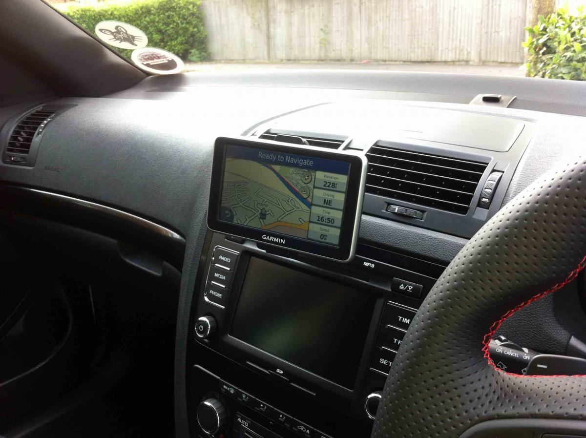

As someone who doesn't really use the phone in the car and prefers a sat nav where I can set the route on the PC with stops etc factored in then the Columbus set up didn't really fit what I wanted.

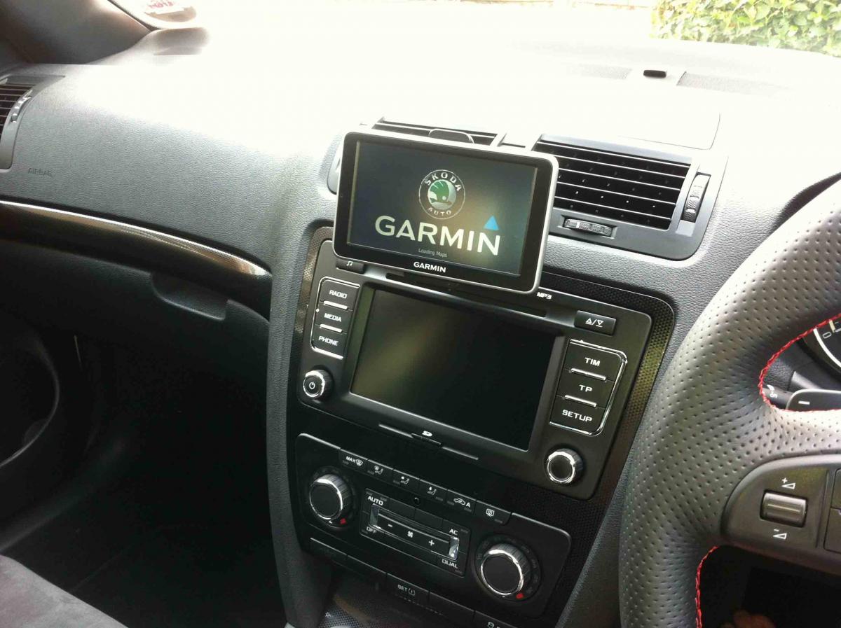

My solution was to hardwire the Garmin in as this gives me all the route planning flexibility I need and the bluetooth on it is bloody good. It also means that I can have the speed camera warnings that are updated weekly.

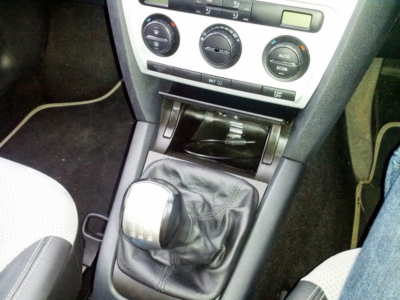

It was a simple fit, popping up the console box and running a wire to a switched live in the fusebox (a switched live was used as the unit has the option to power on and off with the ignition).

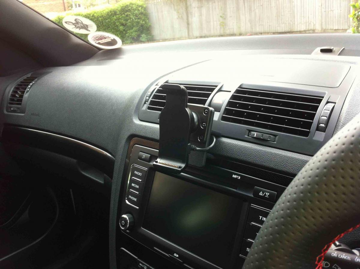

The mount is a Brodit one. I realise that the install may not be everyones taste but it gives you another option other than sticking it to the windscreen.
