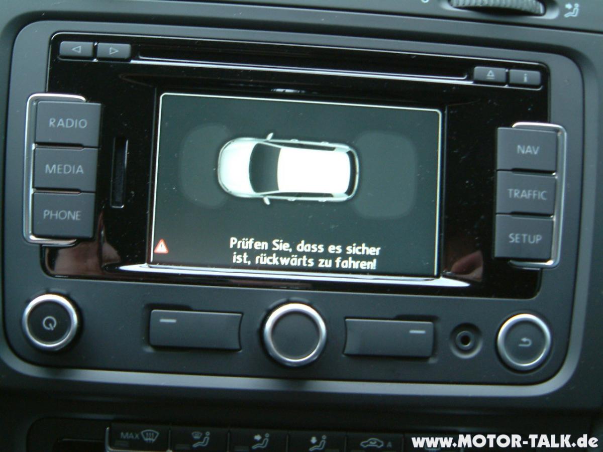

Also, my SE is coming with the Amundsen head unit. If i get oem parking sensors fitted will i be able to have the pdc imaged on the screen of the Amundsen when reversing?

It is possible, but I don't know enough about the Amundsen and compatibility with PDC modules, ABS sensors, and PDC sensors to be a definitive answer.
It should look like this though (but in English) if you have front & rear sensors fitted:
This isn't my picture, I just used the power of Google to find one...

The SE Octy i will be picking up next friday comes with the Amundsen unit. Something about a shortage of the standard units usually found in an Octy. I enquired at the dealer about fitting parking sensors but was told that they would be audio only and i would not have the graphical display.
I don't know enough about it but it sounds to me as though it should be able to show the graphics as well as be audible.

I've a Amundsen and factory fit rear parking sensors. I get a nice little graphic when reversing.
Just to be clear. I don't have any sensors on the car. What I was hoping to do was get some red own ones fitted and hopefully have the display also work on the Amundsen head unit. I am getting the car on Friday. I have already asked the dealer about parking sensors and they have told me they will be audio only. Could I get the required parts and maybe get an independent vag garage to fit them and get the display working?
