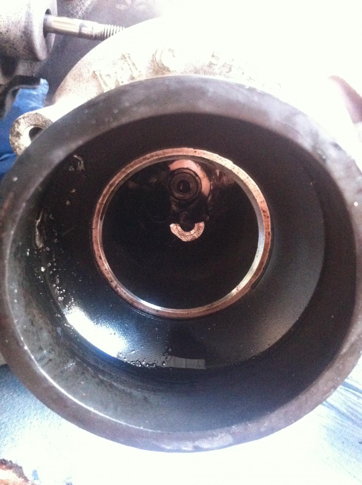

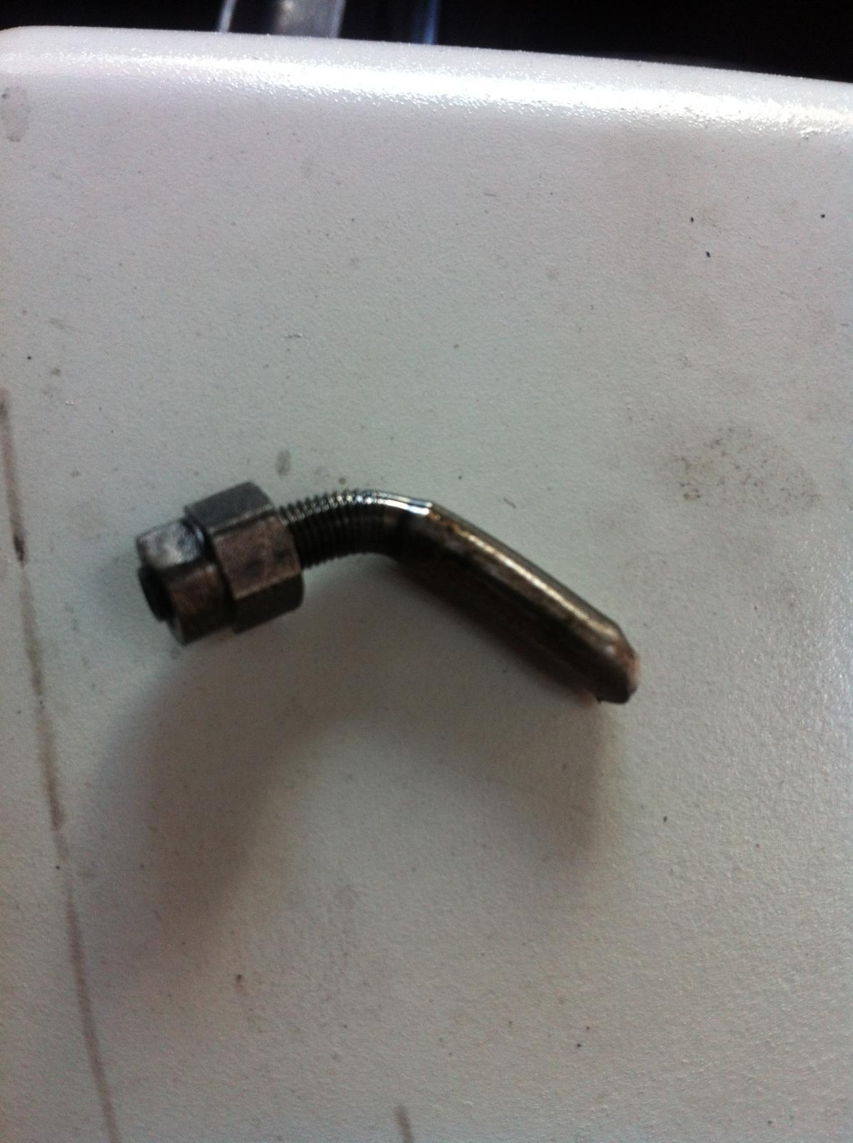

Ive not long had my turbo changed, and at first we took the turbo off and found that the turbo was a mess, with the impeller missing and the shaft and bearings all knackered. After fitting it back to the car after a repair, i was still having problems, which turned out to the boost pipe that connects to the turbo coming from the intercooler, not the bottom one connected to the intercooler, but the top one. I have been driving it since and the whistle seems to be getting louder again and its chucking out loads of black smoke. Does this sound like a leaking boost pipe of some kind?
The first picture below shows the turbo when we first got it off with the impeller missing and parts of it stuck inside, and the second one shows what we found in the turbo, the part being the shaft that holds the impeller in place.
