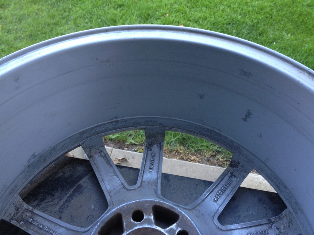

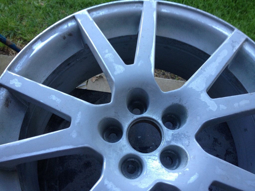

Not bad condition some curbing and scratching but should be able to sand that down. Had a go a sanding the paint and it could take a while!
Bought some nitro morse which should make it a little easier.
Will put some pics up tomorrow.
cant wait to see the pics mate, i just done my spyders in ford graphite grey and they look amazing, personally i think they are the best wheels for the fabia, good luck :D
Well carried on sanding some more, thought it was nice and flat and the dips in the paint were ok to go. So I had a go at painting as I haven't done it before an with this being my practice wheel, I thought what the hell.
Painting went well, it was quite simple and a good learning experience.
The main lesson was that I hadnt sanded enough to get it properly smooth. So back on with sanding tomorrow, bought and electric sander to help out so I should save my fingers.
Also don't use nitro morse on them, as when trying to get some of the paint off it scratches. More lessons learnt!

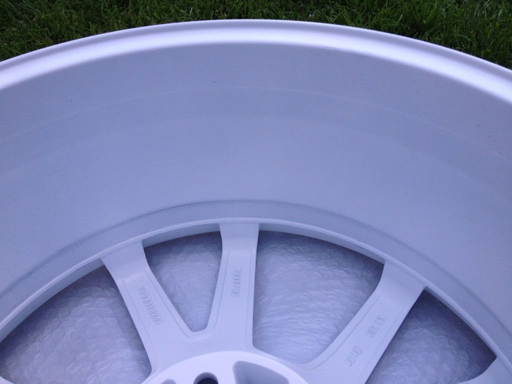

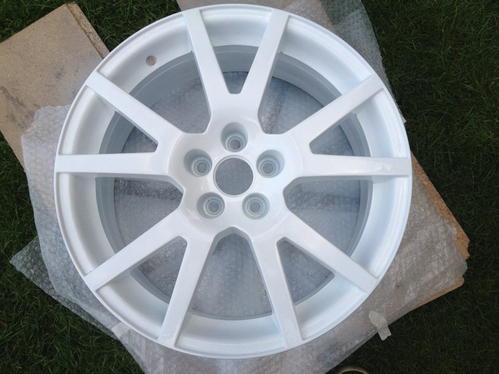

Update time!
1 wheel down and currently drying. It's not perfect but was a good learner wheel so it can be my spare.
2nd wheel is all primed and white on one side and first coat on the front.

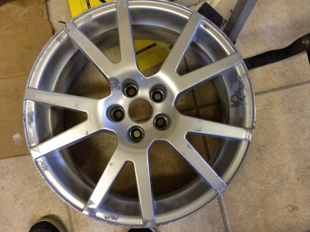

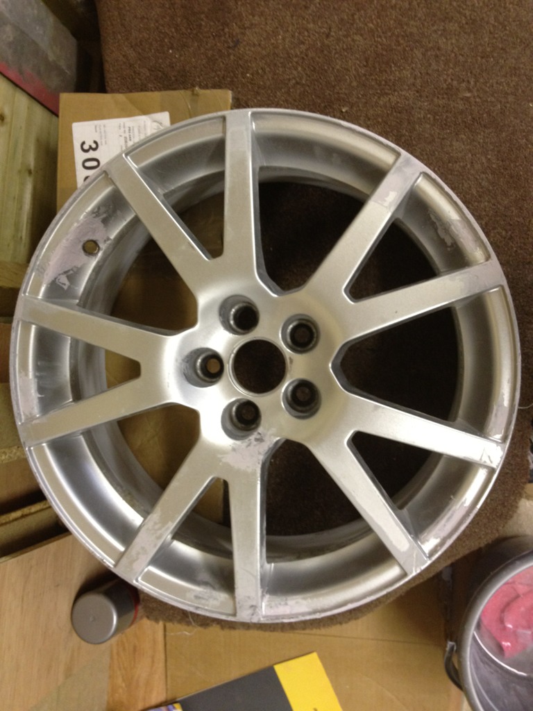

3-5th wheels currently undergoing cleaning up and sanding and some filling.
Thank god I got a dremel as its very useful for the little bits.

Update 2 wheels completely finished. 1 wheel pretty much done, just had to do a touch up, which was a pain :(
4th wheel just started priming but not happy with the front as I haven't got it smooth enough so back out with the sandpaper tomorrow.
5th half way through sanding some more finger & mind numbing work to do.
