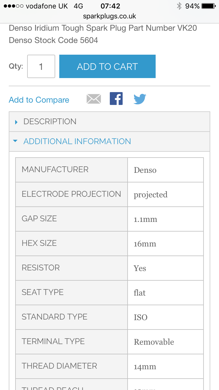

The plugs I've bought are vk20 5604 Denso iridiums. They come gapped at 0.4mm. Will this be OK or do I need to widen the gap as I've read on the main sticky thread that they're normally gapped at 0.8mm.

Are you dead sure they are pre-gapped @ 0.4mm.    Others will have to comment on that.
I have plugs i put in at 0.8, and Skoda / VW now do 0.7 i believe on OEM / NGK.
 Bluespark advised with their tuning box at 0.6.
Just measured them using a coin gap tool and can confirm that they are pre-gapped at 0.4mm out of the box.
Bought them from euro car parts based on the car registration.
Blimey I thought the vk20's came at 1.1mm

This is from spark plugs.co.uk website mate. Just double check because I'd hate you to go thro the hassle of fitting them and the it not run right.
The plug gap is 1.1 from the factory and the electrode is 0.4mm diameter.
Just double checked and it is actually 1mm. I was looking at the wrong side of the gap tool I've borrowed. Right, so the advice is to close the gap down to 0.8mm?
Thank you for making me double check!
