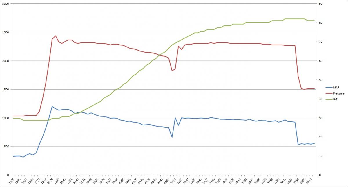

Did a couple of logs today, max temp on abit of a flat out run without going to jail was around 87°
Sound about right?
Was around 35° normal driving.
However... We did find the boost leak!
Just logged mine tonight. 15c outside.
Good results, very similar to ours then, as you can see the intetcooler is in very poor condition also.
