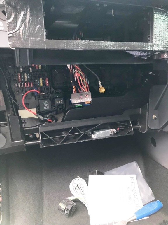

First job was glovebox out and remove the audio control unit using the release keys. Note the duck tape around it to stop me scratching the trim.
This is tricky as you need to release the connectors from below in the glovebox aperture as the unit doesn't come all the way out. Take care here as the coloured connectors are quite fragile as I discovered when one of them broke, thankfully it still went back on afterwards although the locking clip has gone.

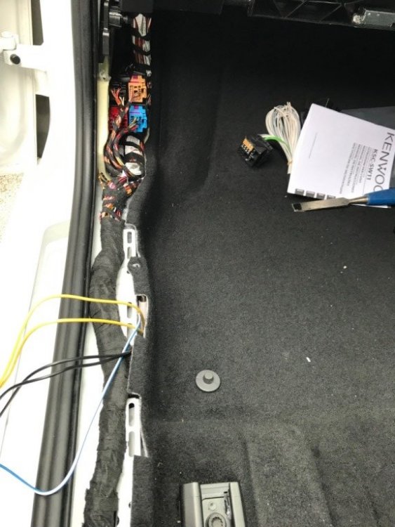

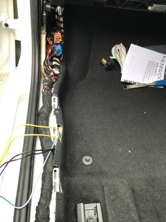

Next I removed the sill trim to give good access under the carpet to run the wires from under the passenger seat up to the fusebox area. The bonnet release handle is tricky to remove but a quick search on YouTube showed how (which basically involves using a long screwdriver to unhook a plastic clip at the back of the handle

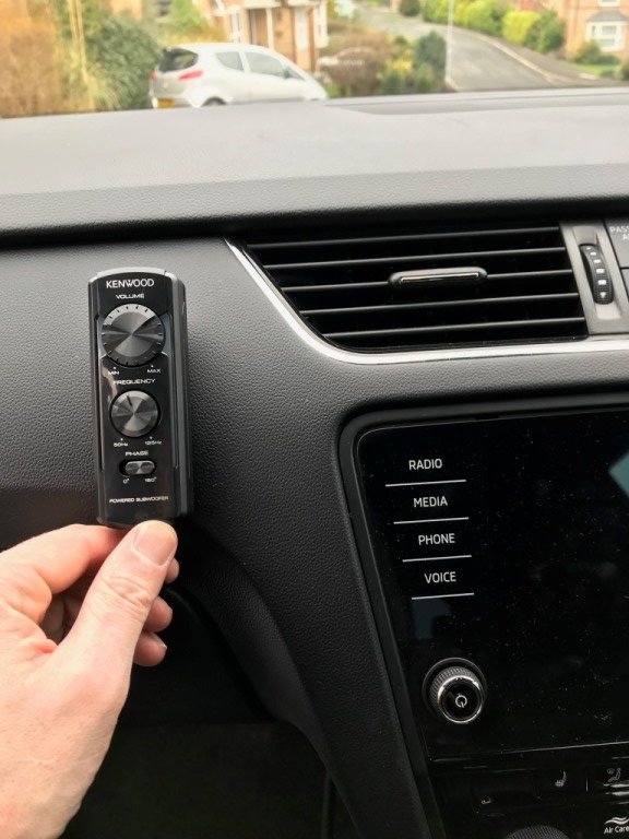

There is a wired remote to control the level, phase and frequency cut-off. I have just run this to the glovebox for now as don;t want it on show in the car.

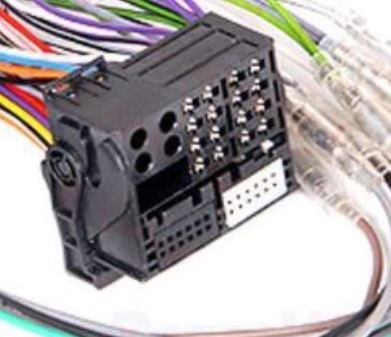

Hmm ok, not sure then, it had far less pins/wires than mine and one of the connections in the main block was completely the wrong shape.

I'll give folk an example of issues I've come up against in the past - both specified as 2017 Mk3 Octavia compatible:
mk3_harness_1.JPG.bb35345df46aeab6392ce4476dcd5ae6.JPGmk3_harness_2.JPG.f6506ed5b36353b5b19fda115bf73853.JPG
