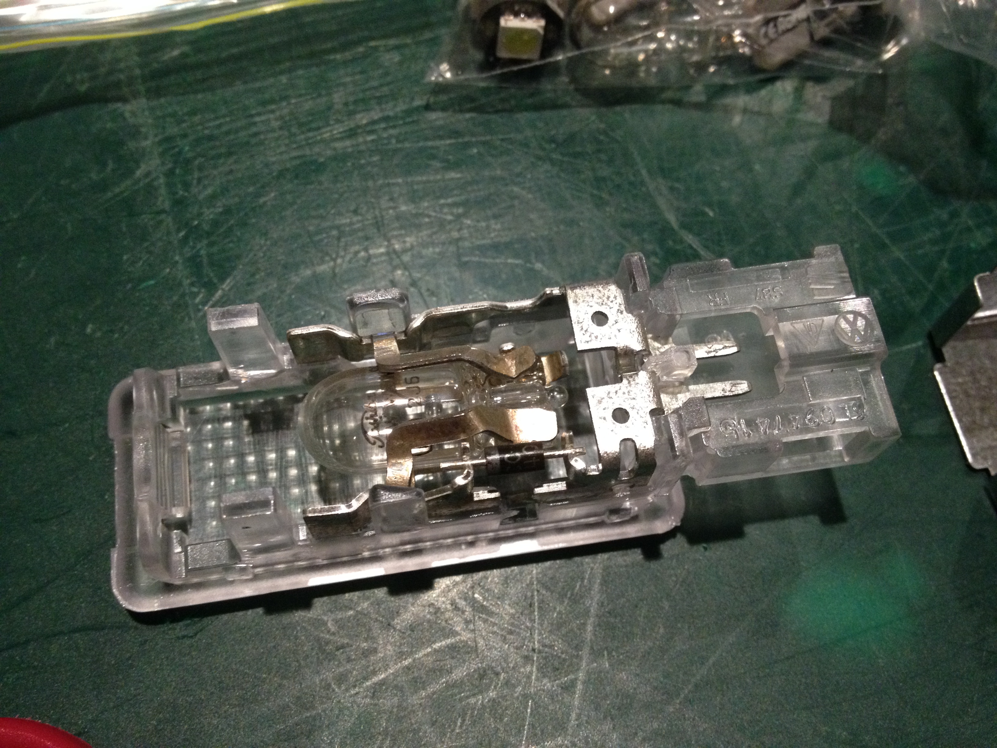

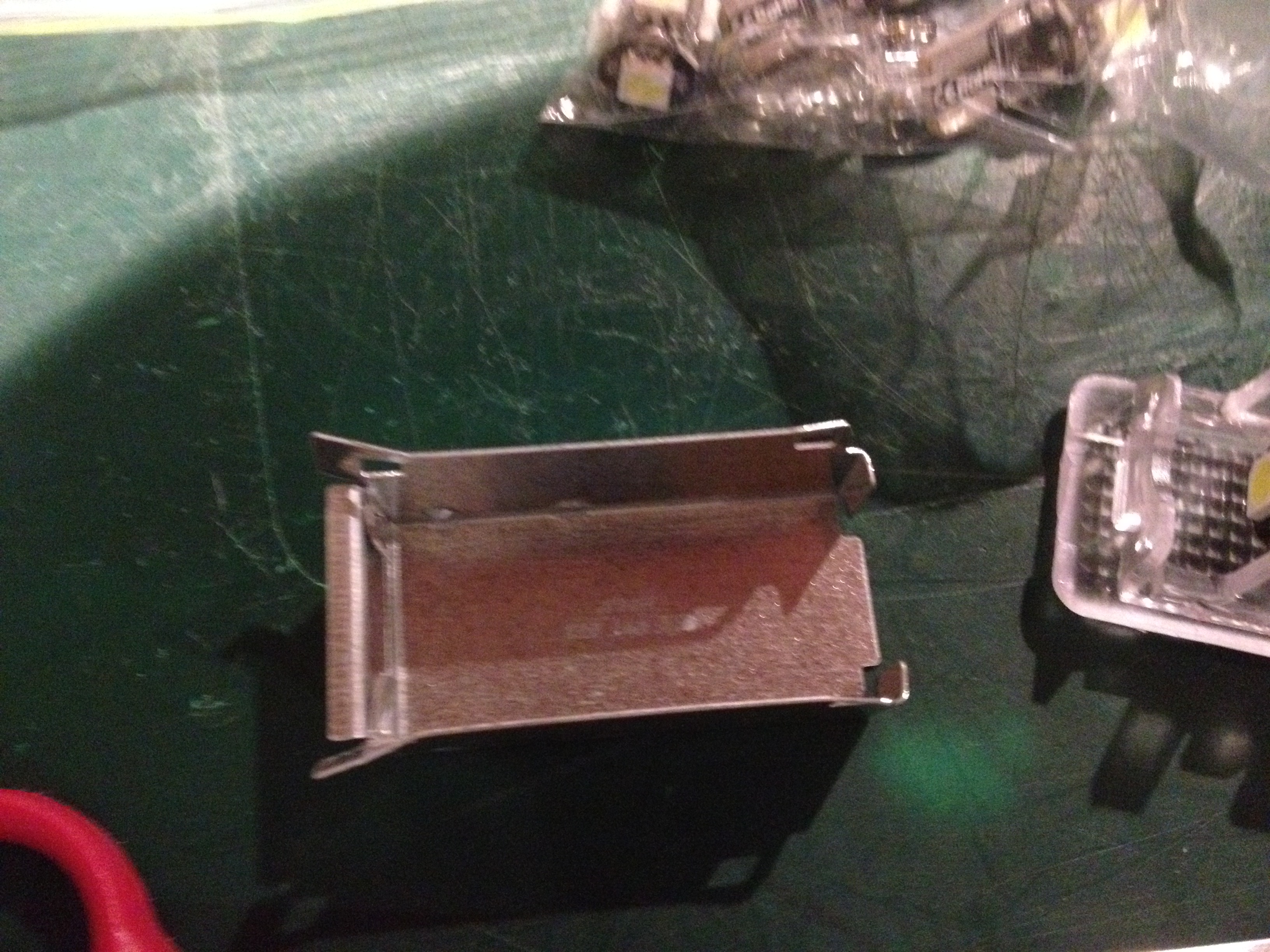

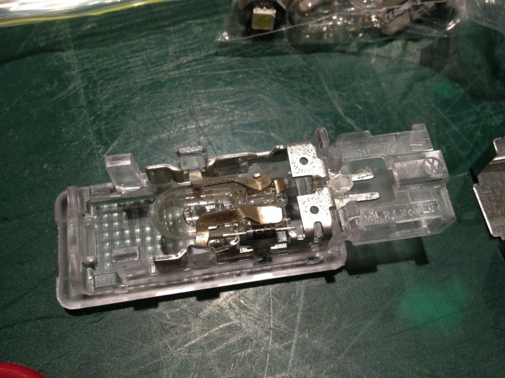

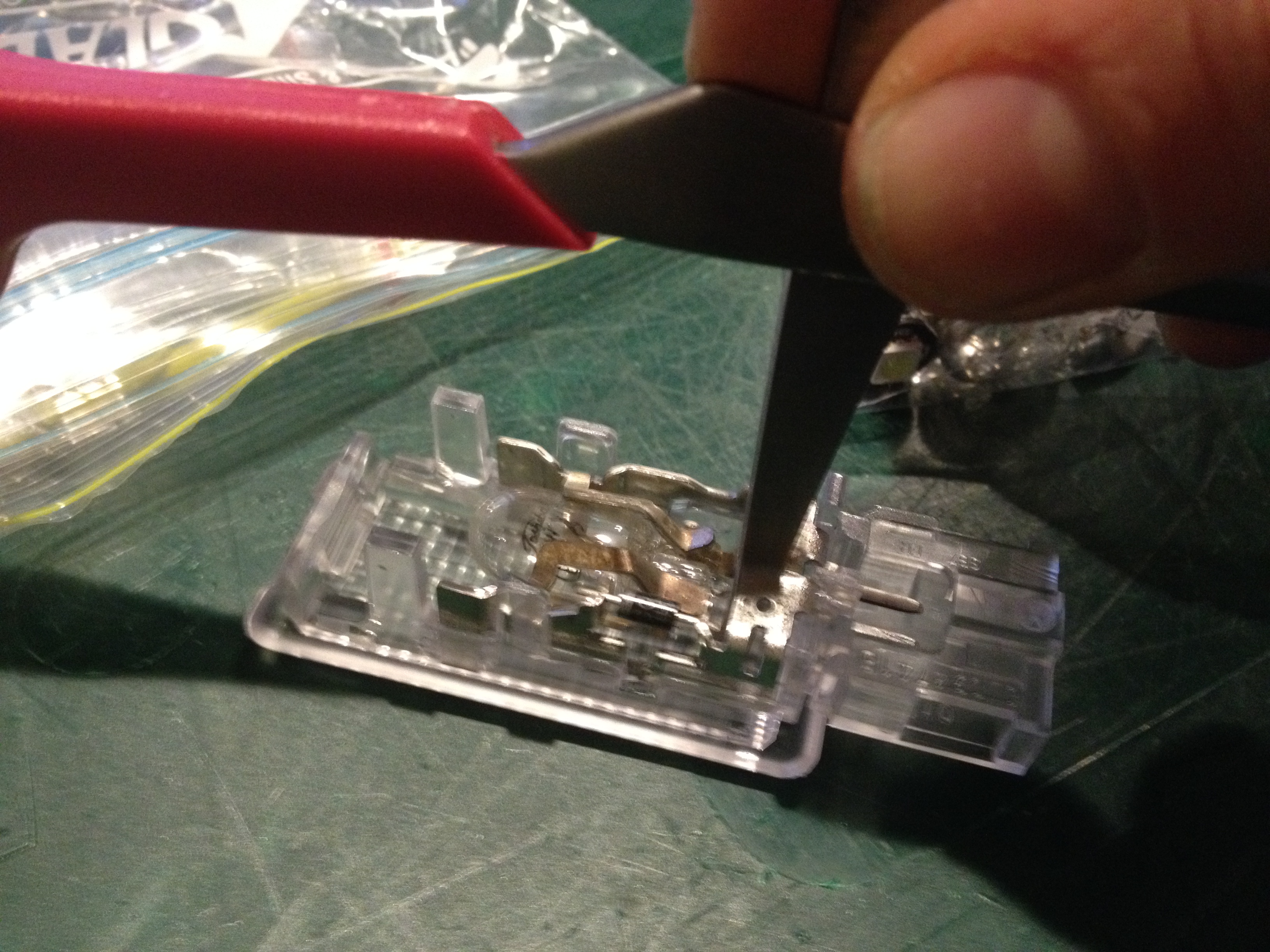

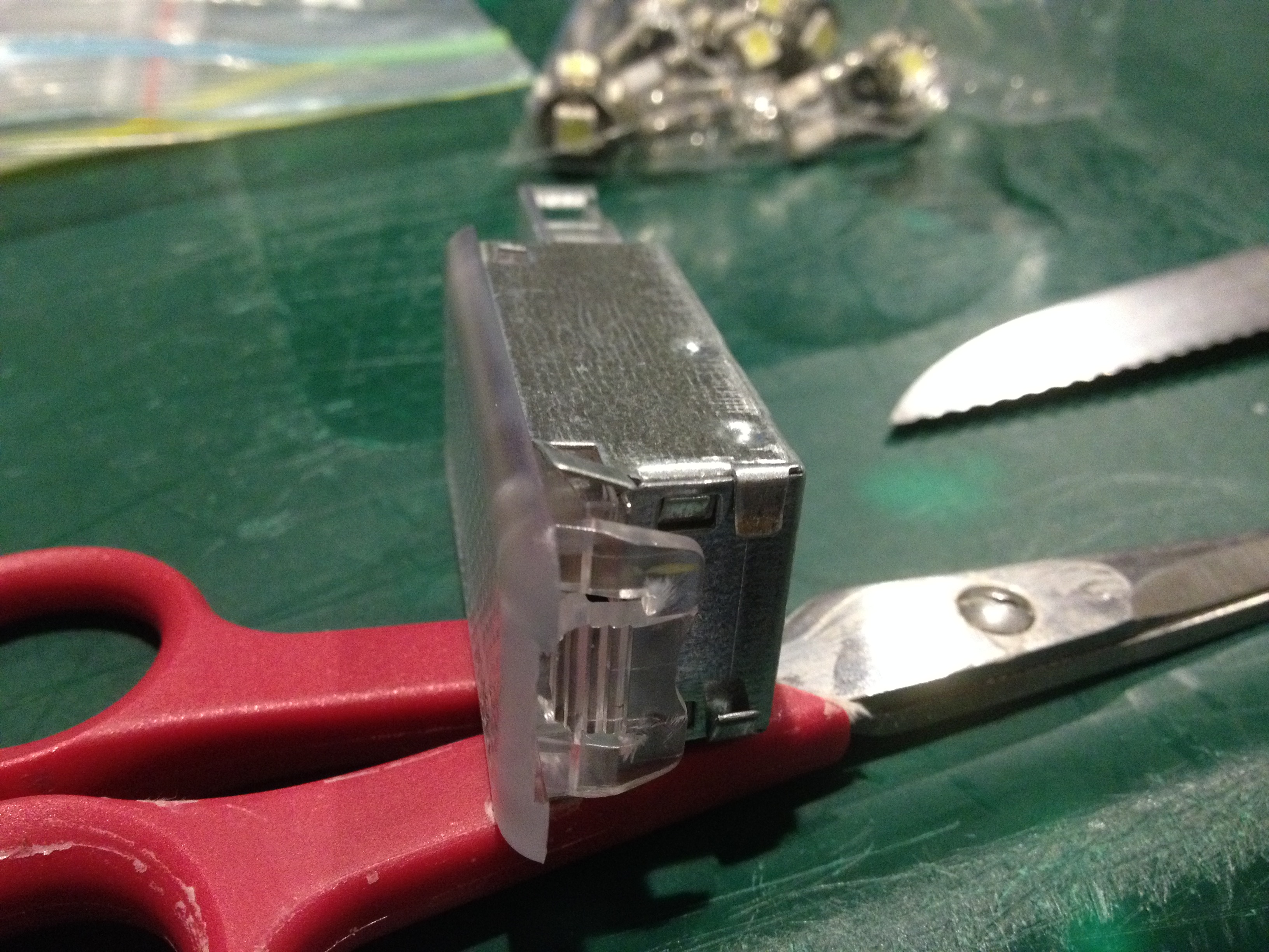

The bulbs are the same w5w as in the front footwell and rear door (estate)
just buy some decent w5w led bulbs (avoid plastic base types)
This should be of some help. The LEDs I used for this application were awful, they turned from white to purple after a few days, so went back to standard bulbs.
b6_bulb removal etc.pdf
