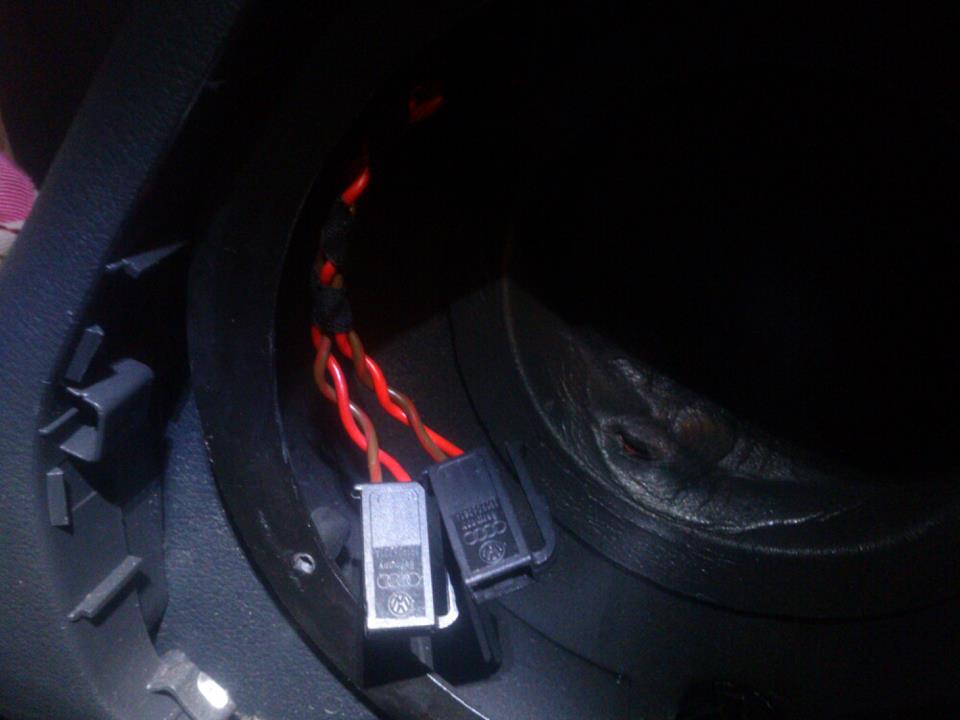

Hey fowks, front left speaker was blown, so got new speakers - fli iv. I have no idea how to change the connection from the old speaker the new ones. There are two clicks in the old, and one 1+ and 1- on the new.
How to go about with 4 cables into this (2 cables for each connection) to alter into the new - and it to work!!
Any help or points be greatly received.
Cheers cheers
Two of the cables are input, two go out to the door tweeters.

I cut off the connectors about an inch down, so there would be enough to re attach later if refiting . Then paired the wires together ( can't remember colours now) and fitted to New speaker, job done. Oh forgot to say, check depth of new speakers as I had to make a spacer out of mdf around the speaker so tge back would clear the inner skin.
Cheers dood - not looked at the drivers, but passengers is red/brown on each connector. Do i cut there, add brown to brown and red to red, then use them for the single + and -?

following on - a pic from passenger side......
Cheers guys - snipped them off, attached the coloured cables together (tweeters) and attached to new speakers - sorted :rofl:
