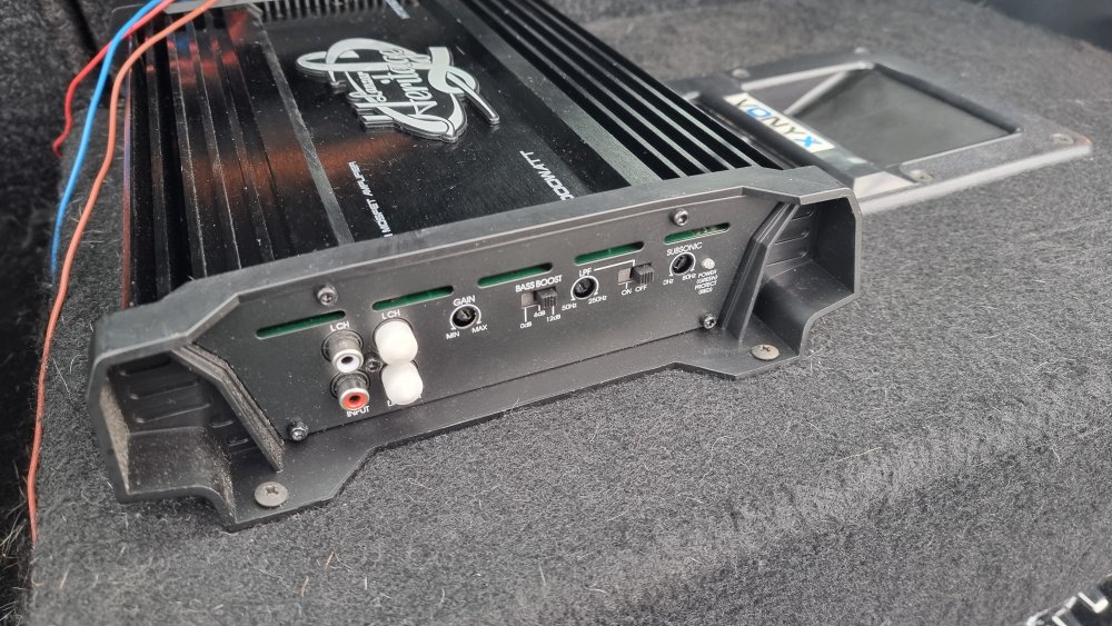

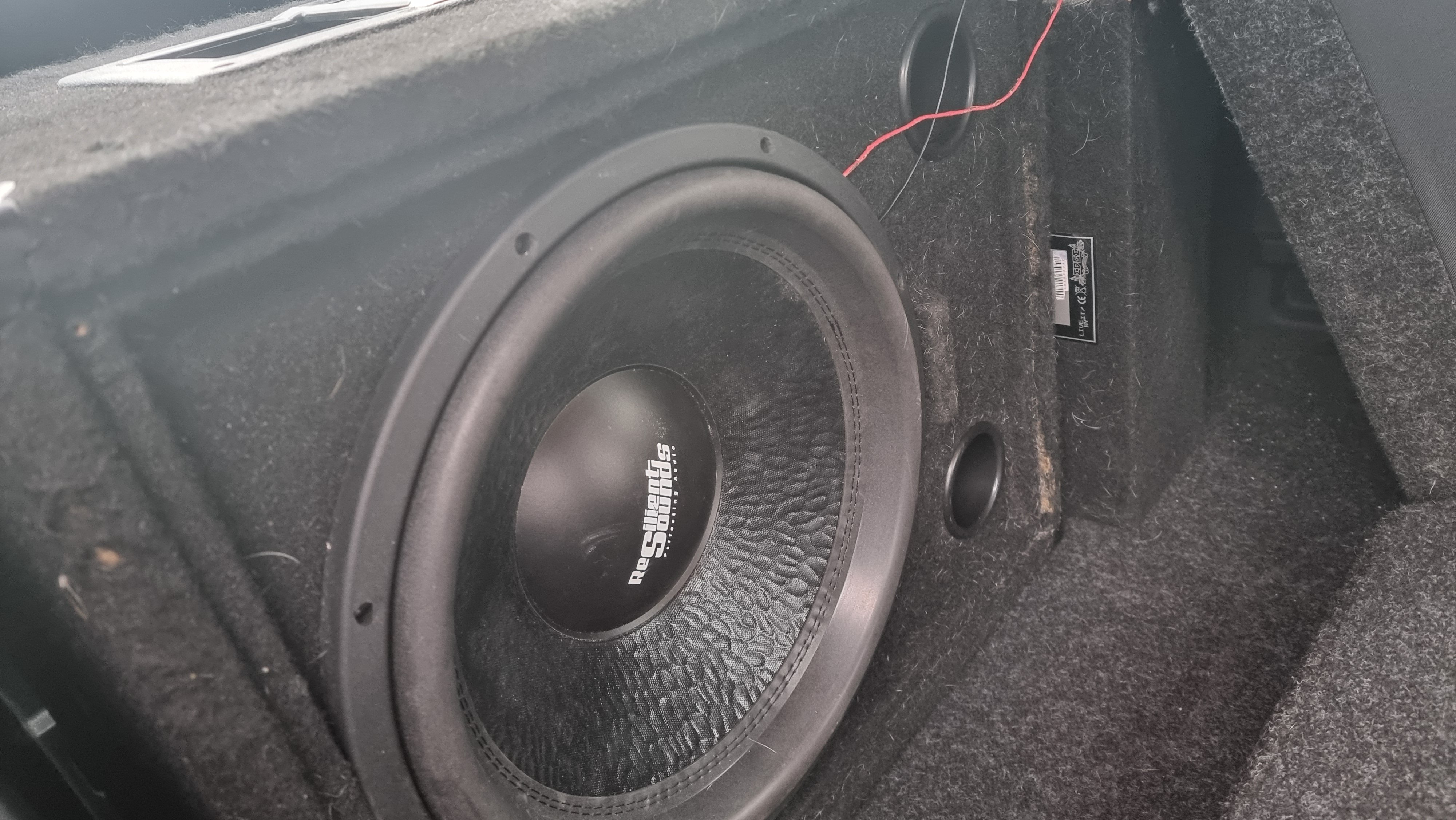

17150007640074369072735308341849.thumb.jpg.edfd3862b77f83fcf9c8b0b471d0886d.jpgOkay, so... I've had my subwoofer in my boot for a while, but I've only been using it through an aux to rca adapter, playing every frequency through it. It sounds **** and I'd like to link it to the stock system. Its an external amp, and I was wondering if there was any way of daisy-chaning my amps rca input to one on the stock amp or system so they play the same thing at the same time. I've looked everywhere I can think of it all being and have found nothing but a fuse box and the cabin airfilter. Any help would be appreciated, thank you for reading.
Yes, the sub is on its side, its supposed to be facing up, yes, I know my wiring is dodgy, its fine

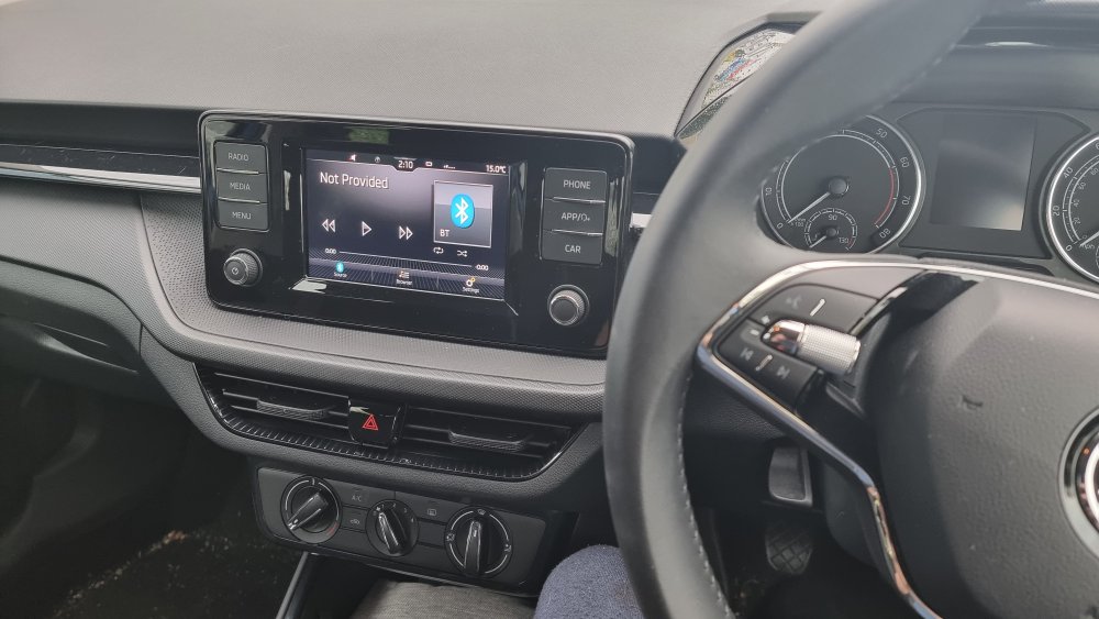

It looks like you're trying to achieve this on a shoestring budget and that's an impossibility with that head unit because there are no RCA outputs.
There are still ways to achieve it but in all honesty
1: The cost wouldn't justify the results you're after
2. Even if you were to fork out mega bucks, in all honesty, you'd be the last person on the planet who should wiring the system up.
I know I shouldn't go any further with this but I can't help myself.  What are those wires that come out between the speaker and the sub housing for?  Don't tell us that's the speaker wire.

Looking at the Owner's Manual (as I always do and suggest all owners do no matter how long they have owned their vehicle) I take it by the 6 physical push buttons you have the Swing Infotainment system.  In the Owners Manual it has -
"Sound settings
The Infotainment system sound is set in the    menu.
The following settings are available in the menu:
. Equaliser
. Volume ratio
. Individual Infotainment functions volume
 - The volume can be adjusted in e.g. one of the following menu items:
 - Volume adjustment of voice commands
 - Maximum volume when the Infotainment system is switched on
 - Speed-dependent volume
 - Muting the Infotainment system with the Parking Aid switched on.
Depending on vehicle equipment, the following advanced sound settings are available:
. Space optimisation
. Audio profiles according to genre
. Subwoofer volume"
So I take it having never seen the system, that if you have it ,in the Swing it's a virtual subwoofer. to set the tone settings is via the equaliser.  (As a former home hi-fi nut, formerly with the tinnitus from it, I've never found a preprogramed tone/profile that wasn't tiring after a short time, but each to their own.)
