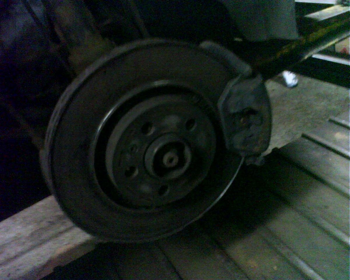

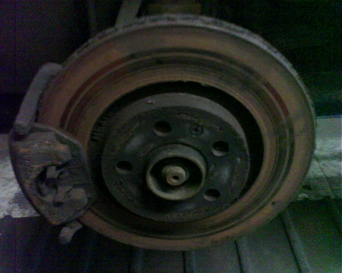

Brake discs have to be really bad to fail a MOT these days, the ones in the pictures below exceed the MOT requirements. As a testing station at work, we've only failed one brake disc in the last two years.

Which to me make the whole MOT irrelevant in terms of safely for modern cars.
