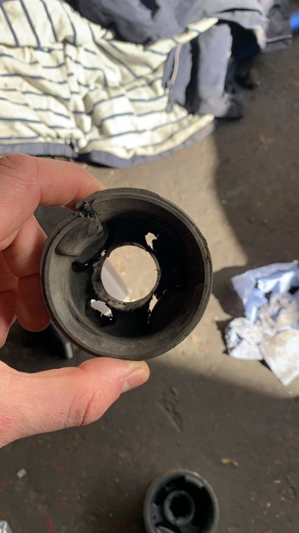

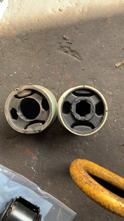

You can see the old bush in the photo below and then again side by side with it's successor; this was the nearside and the worse of the two.
I'm amazed at the difference it has made to the ride, the steering feels tighter and more responsive and it's eliminated the nasty clunking that would occur when braking at low speeds. I had no idea they had gotten so bad or I would have replaced them earlier!
