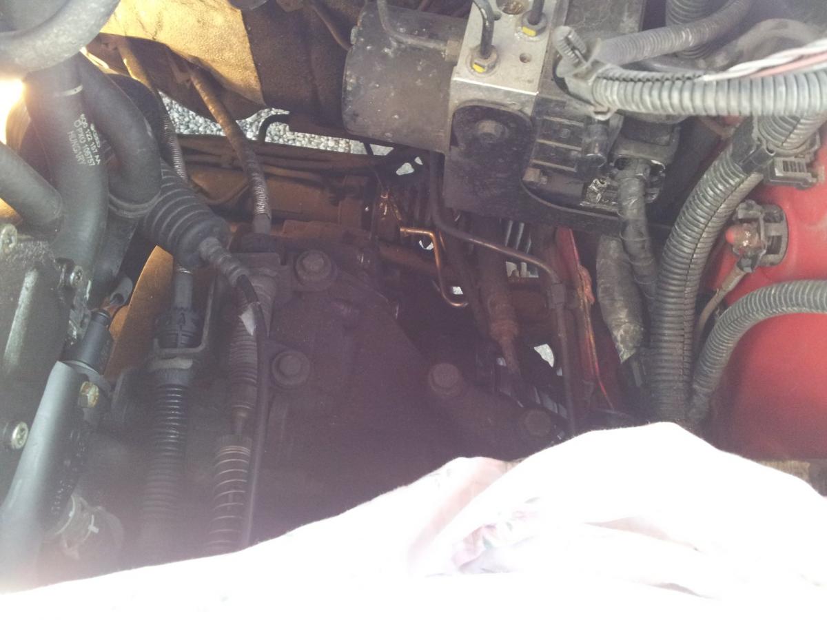

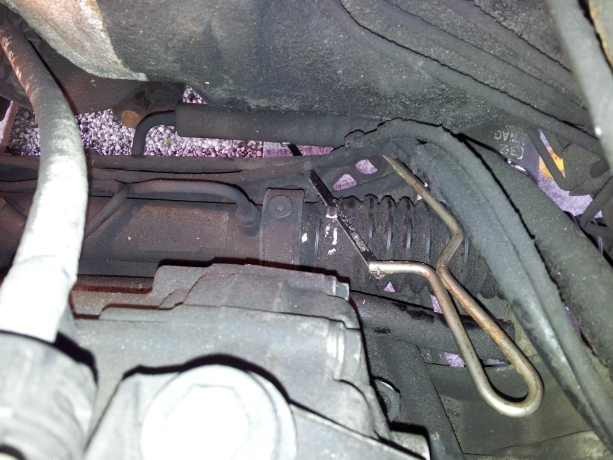

Just in case anyone else reads this and decides they want to attempt to change the track rod on a Fabia.. specfically a MK1 vRS, it's worth taking a look at the pictures below.
I needed to replace the track rod, and track rod end on the passenger side. There is very little clearance to get in and remove the metal tie on the original gater ( inside, closest to steering rack ), when entering via wheel arch. It's also very difficult to get purchase when crimping the replacement metal tie that you get with most track rod kits. I used the following tool for the CVJ metal clip: http://www.ccw-tools.com/product.asp?strPageHistory=search&numSearchStartRecord=1&strParents=0%2C0&CAT_ID=&P_ID=3690
I had to hacksaw the old clip off.
I recommend that you enter through the bonnet. You'll need to remove:

Once you've got everything out of the way, a ladder is useful to get into the engine bay ( I had the car jacked up ).

I think that I used screwdriver(s) to partially open up that crimped point, when you twist that area using a long screwdriver fed in from the wheel arch end, one of two things can happen, you open up the crimped point fully or you open up the crimped point a bit and dislodge the tang on the clip - either way the clip opens up.
