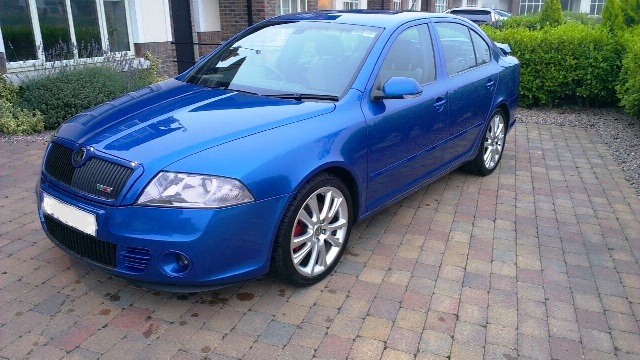

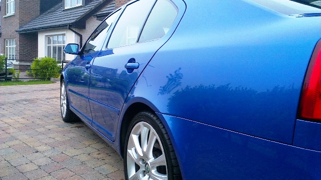

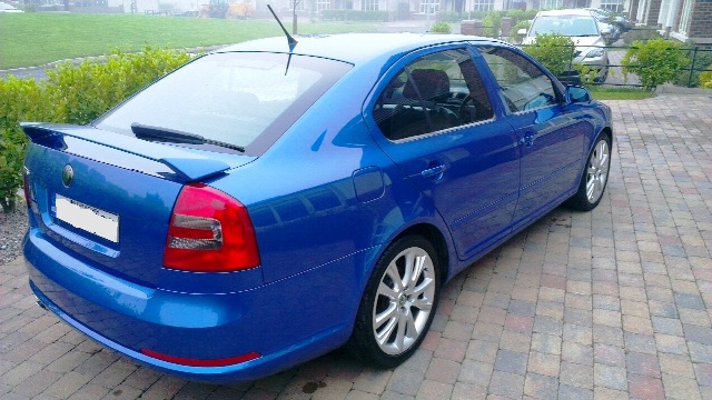

I detailed the RS during the week. Washed the car, clayed the paint, washed the car again, dryed the car and machined polished with a DA6 Pro polisher using farecla G12 and farecla yellow waffel pad. Then refined with Concept nano polish with rotary polisher, jet washed to remove any dust dried again and finished to colinite 915 wax with 2 coats. Would have posted pics but reached my limit :(
