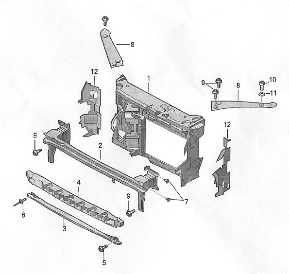

This is the 'lock carrier D' (radiator support to us!) from the ETKA parts list for my 13 June 2012 build Elegance 75PS Greentech. Note no separate cover is shown. As I stated on 1st October (page 3), the parts list wording states this carrier (180 805 588 D) is used up to 24/10/2012. From 25/10/11 (this must be a misprint and mean 2012) it is replaced by 180 805 588 F.
The subject is open for discussion!

  • Looked at the Cititgo's in my dealer this pm. None had the 'cover'. Checked in the parts dept listings and it is not shown as a separate part either, only the complete plastic frame known as a 'loc
