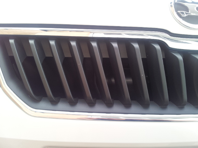

  • Doesn't touch the alternator at all and there is a pipe running down in front of the said shield and alternator, aircon pipe maybe. It started raining when I looked earlier, I'll take some pics of it
  • Found it !!! Here is the pic of the front radiator/grille assembly when it was removed from the car to trial fit the new engine. This is the non-Greentec 60PS SE. (With the same cover as a 75PS Gree

MickA - looking at the photograph of your cover, I am intrigued by the scratches. Cars that come off the production line just don't look like that! Two scenarios:
1). Somebody tried to remove it because it shouldn't be there.
2). Somebody fitted it later because it should be.
You takes your pick! :-(
I have also been studying yours and BossFox's pictures of the cover - they don't seem to be of the same type and shape. I have been using what appears to be a radiator, or aircon pipe apparent in both as a reference. What do you think?
Marks, scratches, thumb prints etc show up to look worst than they are, especially on black plastic surfaces. On my photos those scratches don't really mean that panel has been messed with. And has been said the part needs to be in place before the front of the car is bolted on because I can't see a way of adding or removing it otherwise. :think:
